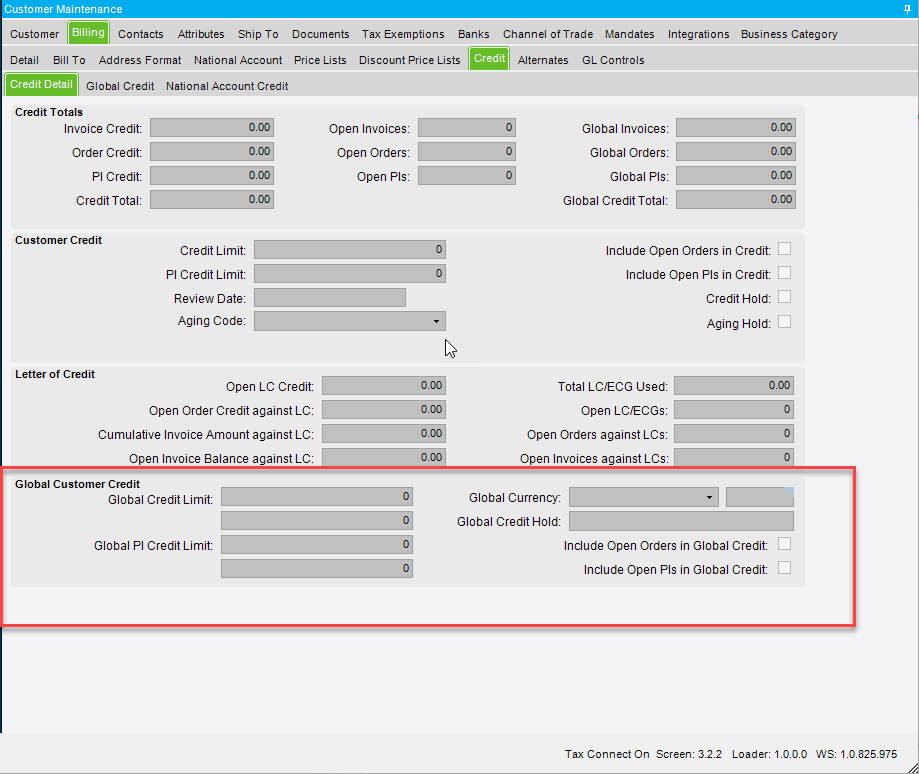

We use the Global Credit Hold pretty extensively. All Customers are created in the Parent Company and Linked to the Children.
As of about 3-4 weeks ago, all Customers for one particular Child Company stopped receiving the Global Credit Hold. Multi Company Direct runs as a process set in the parent and all children. That hasn’t changed, and still seems to be working correctly. The other Child companies still receive the Global Credit Hold from the Parent as expected.

  4. Went into the target Child Company > Customer Credit Manager, and ran Actions > Mass Credit Information update, filtered on the test Customer. No Change.

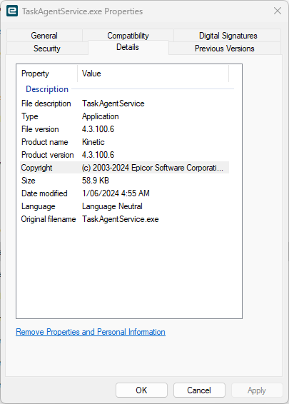

Take a look at the properties of the C:\Program Files (x86)\Epicor Software\Epicor Task Agent Service 4.3.100\TasktAgentService.exe
This folder is an example if you are on an earlier version it will be a different number (I think it wil lbe 4.2.200 I could be wrong :frowning:)
Here’s an example

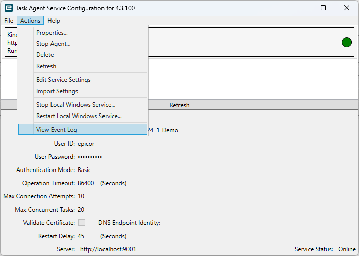

Have you reviewed all logs?
Is there anything in this log
4.2.100.11
Does that 100.11 correspond to the Epicor version? If so holy cow it never got updated since the first pass during our upgrade.
