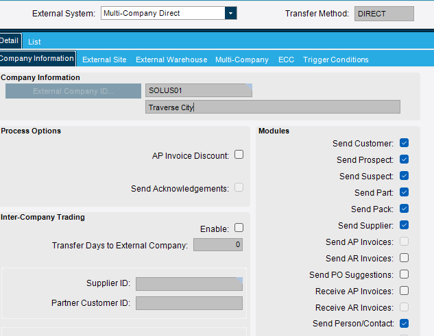

I’m having an issue where newly added ship-to locations and contacts entered for Global Customers are not updating in our other companies. I can tell they are still linked because in the company that isn’t the owner of the customer I cannot edit basic details like I can if I’m in the owner company.
I tried running Multi-Company Direct Server Process, but it doesn’t seem to have updated properly. This is what our External Company Configuration looks like on both sides:
