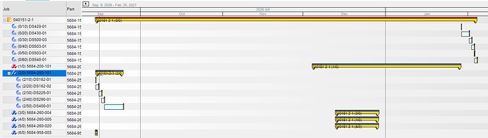

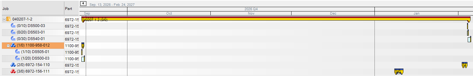

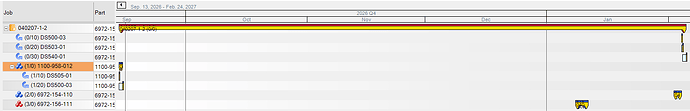

Some extreme examples are shown below:
  1. Assembly 1 is scheduled to start in September but the parent isn’t due until February
  2. Assembly 2 is starting too early as well as 3,4,5 & 6
If I were to rerun these jobs in Job Entry against finite capacity and minimize WIP, they would schedule more reasonable. I’ve also tried using the load leveler but due to our complexity, it just crashes after hours of running.
