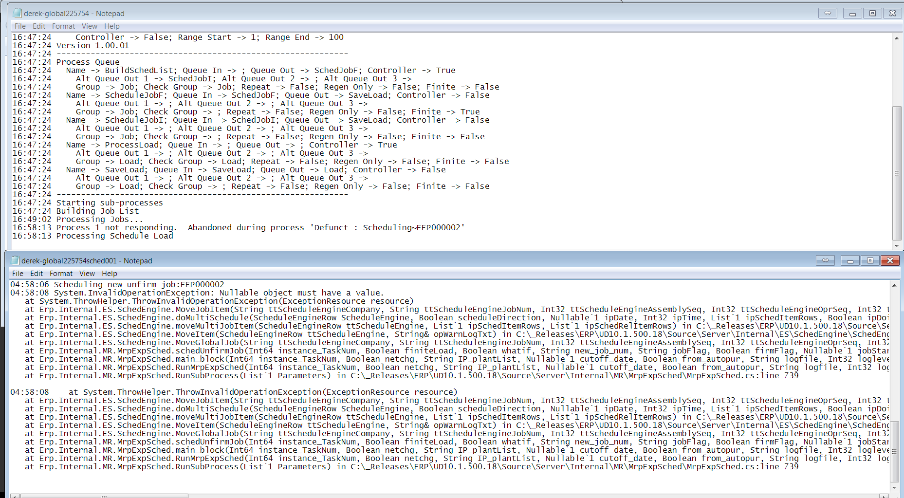

Does anyone have any experience with the following Error when running Global Scheduling?
We’ve seen this from time to time. What we found is that some Jobs have a scheduled end date but no scheduled start date. This alone is not the problem seen here but it identifies the candidates of jobs that are throwing the error.
We wrote a BAQ that looks for jobs with a scheduled end data and no start date and manually reschedule them. Eventually, we run into the job that is throwing the error. We remove the schedule and then reschedule it and that usually takes care of the issue.
Mark W.
Looks also like somehow we tried to schedule a Job without any operations.
