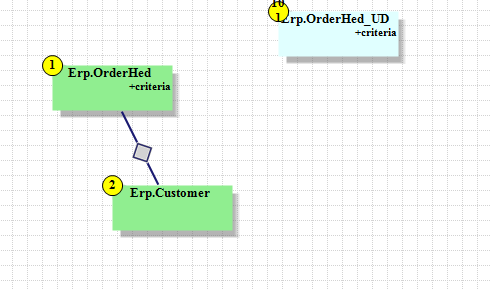

it is a simple BAQ. Because of it my Dashboard takes soooo long it never ends and it affected all the users. Had to kill my Epicor.
Why does it do this ? I redid twice and got the same issue…

There is discussion on this issue here:
The way I work around it is to use the Kinetic version of the BAQ designer.
If it’s already been saved with this defect - you might have to re-create the BAQ from zero. I haven’t heard of anyone re-joining these linked tables.
I’ve seen that happen without Kinetic a few times (we’re not on Kinetic yet), when that happens, I have to delete the table (and the ghost _UD table) from the BAQ and re-add it. Usually that fixes it.
Yeah I did this once and it came back. I followed the use of the Kinetic (on the web) to redo my BAQ and that worked. for now… ![]()
