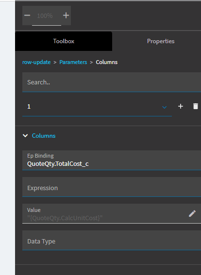

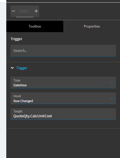

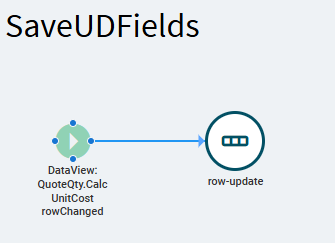

In quote entry, I’m trying to save a couple of calculated fields into UD fields. The fields are quoteqty.calcunitcost, quoteqty.quotedprofit, and quoteqty.wqunitprice. I was able to successfully do this in classic, but need to get this customization over to kinetic. I’ve been trying to setup an event on the calcunitcost for testing, with a trigger on the dataview, hook: row changed, and target of quoteqty.calcunitcost. From there, I did a row-update and in the parameters I put the epibinding to my ud field and the value of “{QuoteQty.CalcUnitCost}”. So far, nothing is being stored. I’m wondering if I either have the wrong trigger or if the value needs to be entered differently since I’m working with a dataview value. Any suggestions would be greatly appreciated.

If you’re looking for a value of a specific field (column) change to trigger an event… you may want to set your trigger to:
DataTable
Column Changed
Target: QuoteQty
Columns: CalcUnitCost
I’m thinking your row update may not be setting your value because, although the value is changing, you’re still on the same ROW. What you may be looking for is when the COLUMN changes.

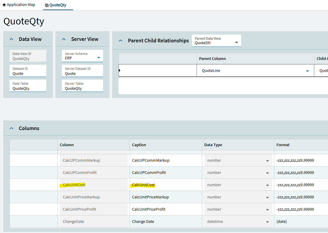

Even though it is not a db field, it IS included in a dataview. Therefore, the value is held in that dataview during your quote entry session(s). So, the value IS there (locally) during runtime for you to grab and plug into another column for long-term storage (server-side).

Is the row-update working to the point that you can see the value in your UD column?
You can see the values held in a particular dataview in the debugger.
OR, if you added a quick number box somewhere on the screen bound to QuoteQty.TotalCost_c… do you see a value populate there after your event runs?
And yes, the row-update will (hopefully) set the value LOCALLY… but you’ll need to call an update event that saves the value to the server. Again, you can test this by clicking the existing save button and see if your UD column value saves in the DB table. UD Columns should save along with the rest of the updated dataset.

Do you see your event firing in the debugger when the original column’s value changes?
After further testing, I was able to see the event triggering from the debugger, but it is not copying anything to my ud field. I even tried a different action for dataview copy and then a data commit, but still no dice. Why does this have to be so hard? I thought app studio was going to be easy, but just another headache.

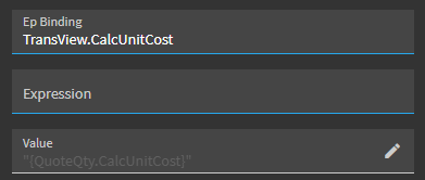

I could then see anytime the QuoteQty.CalcUnitCost changed, my test column (TransView.CalcUnitCost) would also change:
If you’re seeing your event fire… then it could just be a syntax on setting the value. So, perhaps the snip of my row-update above may help?
