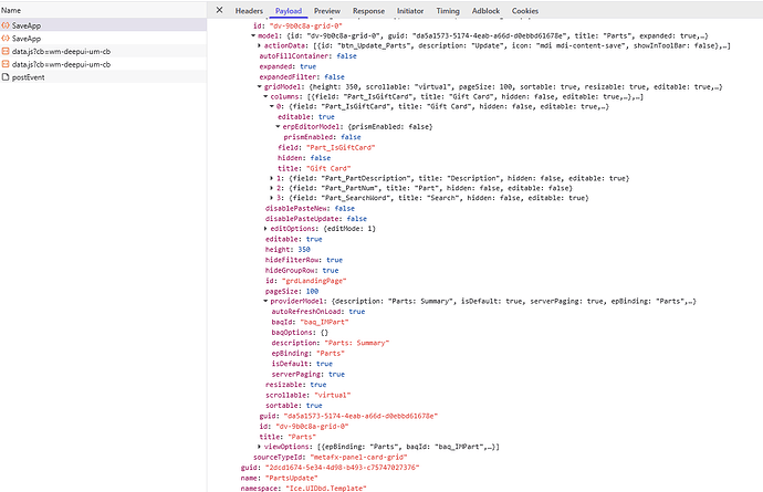

Curious if there’s any change if you wipe out ErpEditor, ErpEditorModel everywhere you can find it.
looks like the same, just bool converts to value (true/false) and instead of click box, you need to type value manually :smiley:

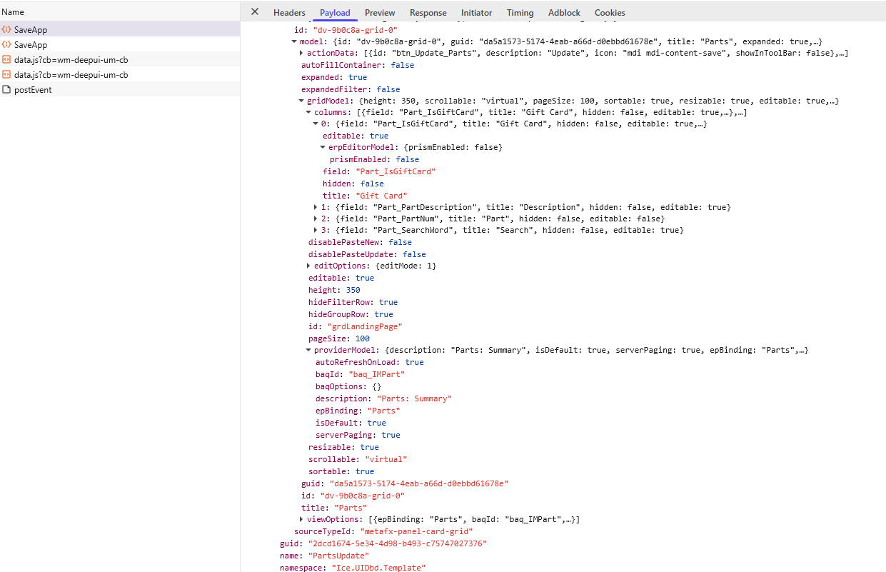

Some how yours is getting a weird ErpEditorModel (rendering a label inside the cell).
perhaps make a quick dashboard w app wizard and compare SaveApp. mine works with no erpEditor, no erpEditorModel on gridModel.column, epBinding & BAQid in ProviderModel (not gridModel). grid.editable = true, column.editable = true

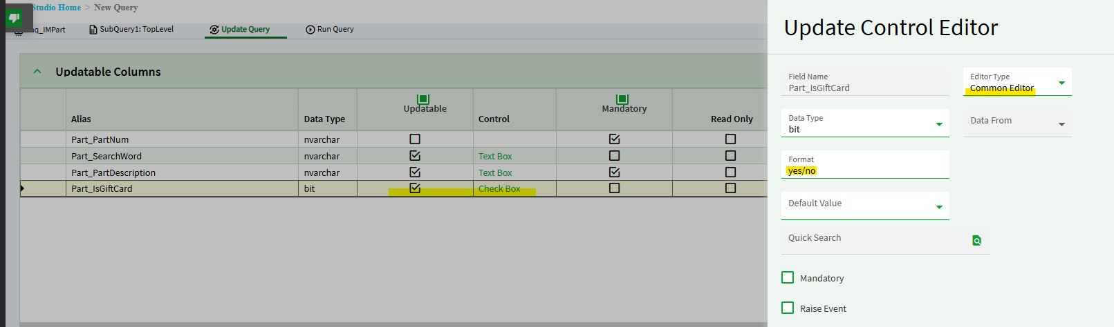

Also checkbox, common editor, yes/no in Baq settings:
