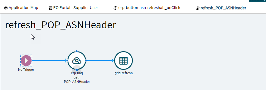

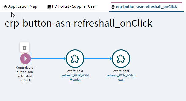

Here is the Custom refresh button event that works correctly:
I do not have any custom events tied to the panel card expand or other areas that would initially load the grid, it was working before just fine when you first expand the panel card. I have since then removed the previously working BAQ Option Where clause filter items in an attempt to fix the load, assuming those were somehow the issue. But to no avail.
