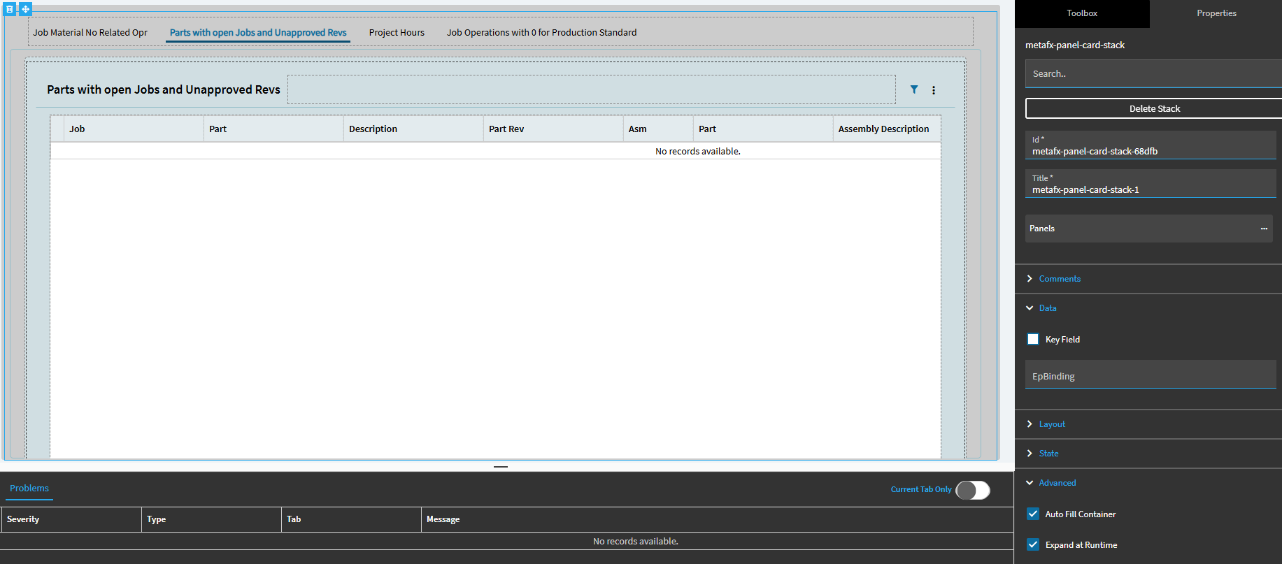

I am uplifting dashboards and deployed a classic dashboard in Kinetic.
The dashboard came in as a Panel Card Stack. When clicking on the respective tabs, I would like the grid to expand and refresh with data. The panel stack is check marked auto fill container and expand at runtime

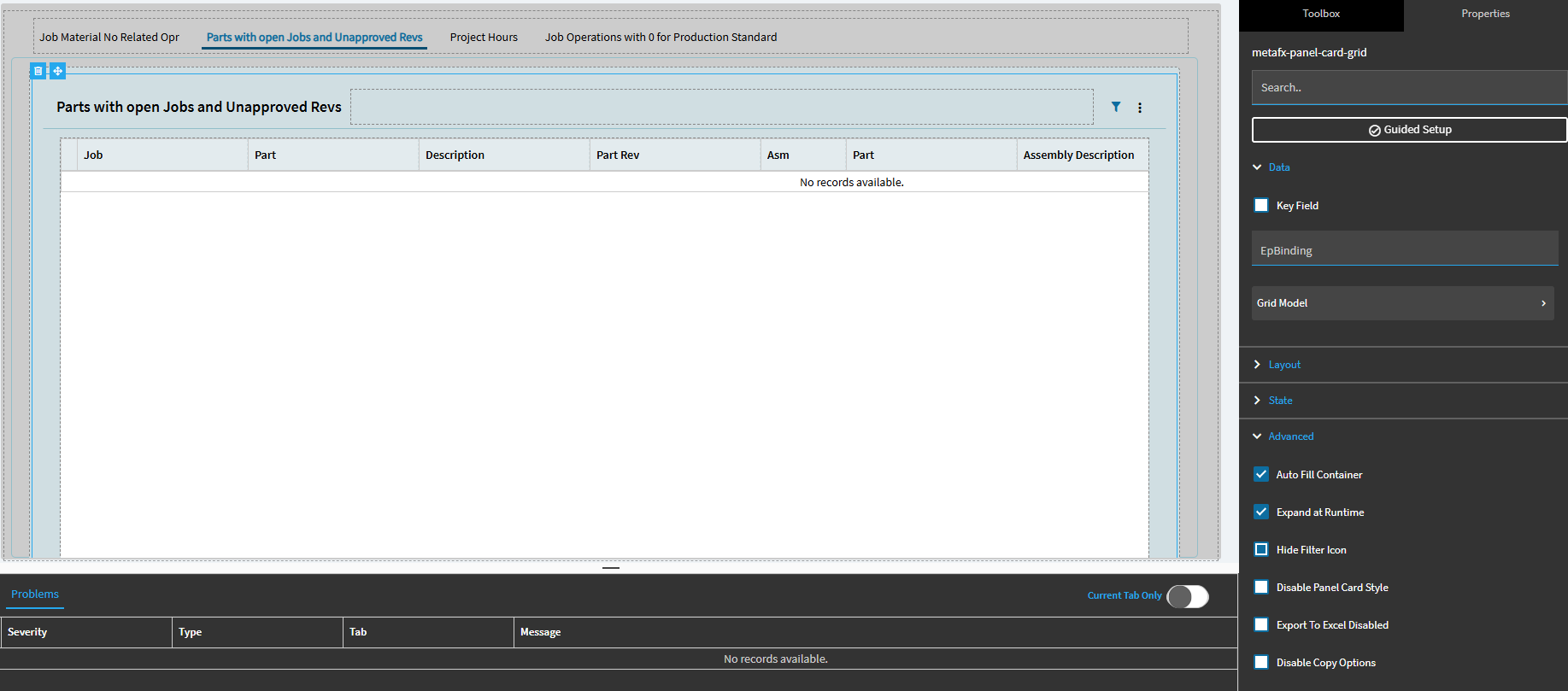

The panel grid card is the same, check marked auto fill container and expand at runtime.

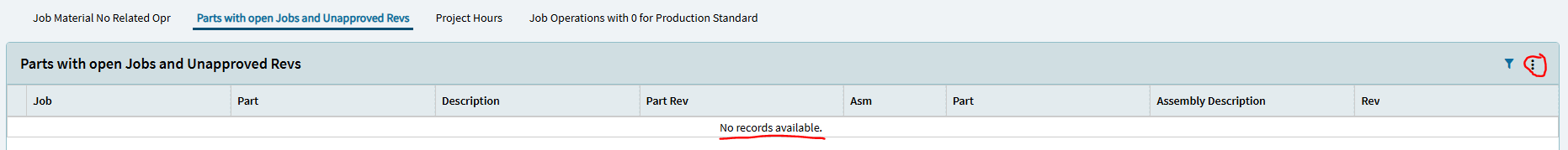

When I preview this kinetic dashboard, all I see are No Records Available.
I have to go to the 3 dots and click Refresh Grid to get the dashboard to load the data.

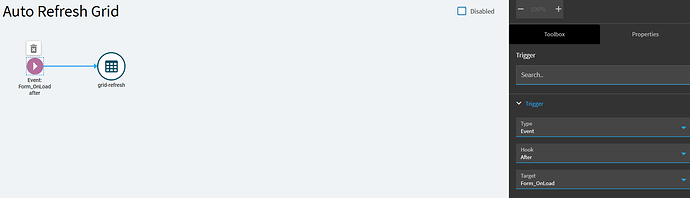

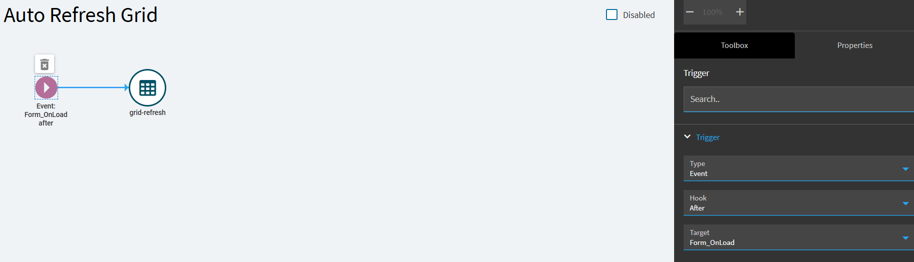

I have built an event to refresh the grids and that is accomplishing my goal but it seems like there should be a simpler way.

Heide:
auto fill container
Just as a note, this does nothing for data. Checking this just tells the grid to take up the full container it’s in.
How are the grids configured? Are you using the Provider Model?
This would automatically retrieve data when the card is expanded.
If you just bound your Grid Model to a view, then you would need to create an event on load to populate said view.

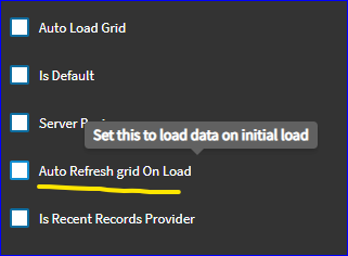

You could try this checkbox under Grid Model > Provider Model…
Can’t attest for whether it would work in your situation or not.
Heide
(Heide Warren)
November 27, 2024, 5:58pm
4
That was the check box that I was missing. Thank you for telling me about the checkbox and where it was located.
Thank you!
