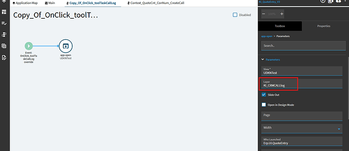

2. Case Entry
  • Created a custom layer for Erp.UI.HelpDeskEntry
  • Copied OnClick_toolTaskCallLog
  • Overrode the system OnClick_toolTaskCallLog
  • In App-Open, set:
    • Application ID: CRGO6100 (the original one is also CRGO6100)
    • Layer: CRMCallEntry custom layer
However, the customization does not appear in the Call Log slide-out when launched from Case Entry.

Have you tried putting this in for the Application ID (“View” in 2025.1.13) in the App-Open event parameters, rather than the menu ID?
Tested and it’s still the same outcome.

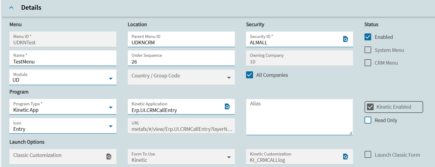

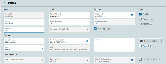

Is that view, UDKNTest on a menu and enabled? Is that custom layer for the same application as is applied to view UDKNTest menu (not that it’s applied to the menu, just that it’s available to select for that applicaion)?
And, again, what does debugging tell you it’s doing when you click the button?
@d_inman menu is enabled and custom layer is enabled already . please find below.,

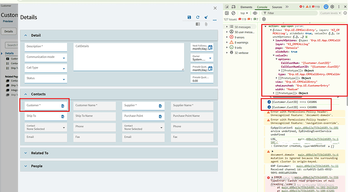

Hi @Banderson / @d_inman / @mark_wonsil / @evan_purdy,

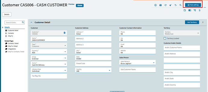

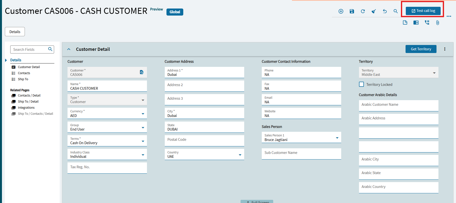

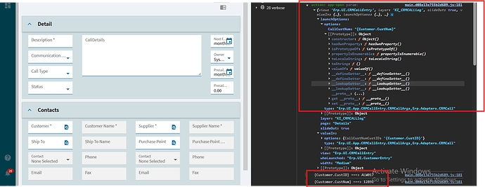

Understand, the Kinetic version is not possible customization, but i’m adding one new tool button and while clicking custid is not coming call log form.,

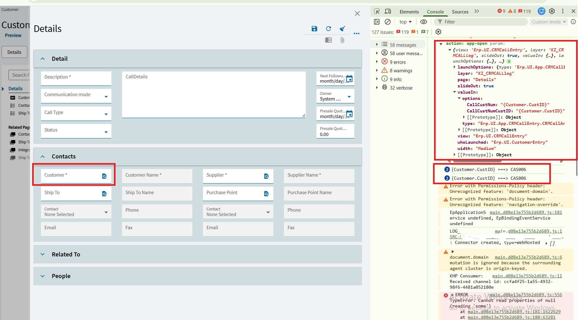

Launching options given value also, debug code also added below screenshot
please find the below screenshots, any idea about this.,

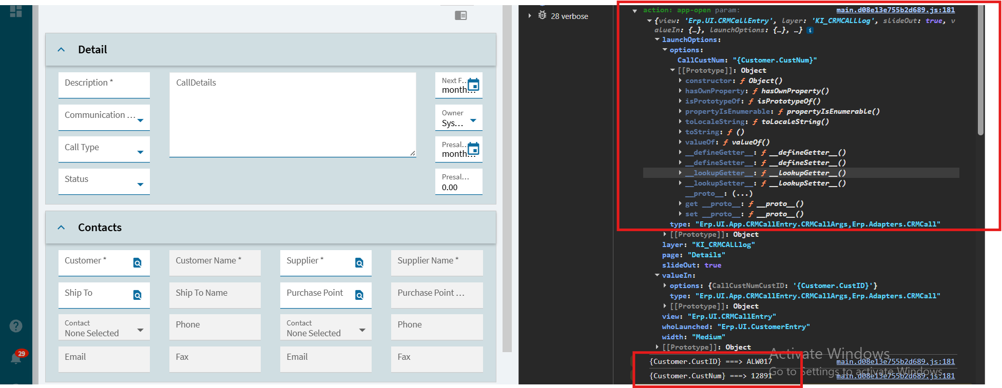

Launching options any mistake? Kindly let me know., check the below debug
We don’t have CRM, so I don’t seem to have the event that you’re trying to override. (Oops, I thought you were in Customer Entry, not Quote Entry.) I would suggest looking at that event to see if the app-open there has the launch options any different. The base event is getting the CustNum from the Task, not the Customer like you are showing. For whatever reason maybe it can’t get it from the Customer table that you’re passing.
Here’s the Launch Options of the base event:
{  "type": "Erp.UI.App.CRMCallEntry.CRMCallArgs,Erp.Adapters.CRMCall",
    "options": {
                "RelatedToFile": "Task",
                "PrimaryID": "{Task.Key1}",
                "CustomerNum": "{Task.TaskCustNum}",
                "TaskID": "{Task.TaskID}",
                "TaskSeqNum": "{Task.TaskSeqNum}",
                "TaskRelatedToFile": "{Task.RelatedToFile}",
                "showAsModal": true
Also, since @Banderson said above that you can’t customize the call log slide out in this version, then maybe also try removing your customer layer and see if the customer details are then shown correctly.
