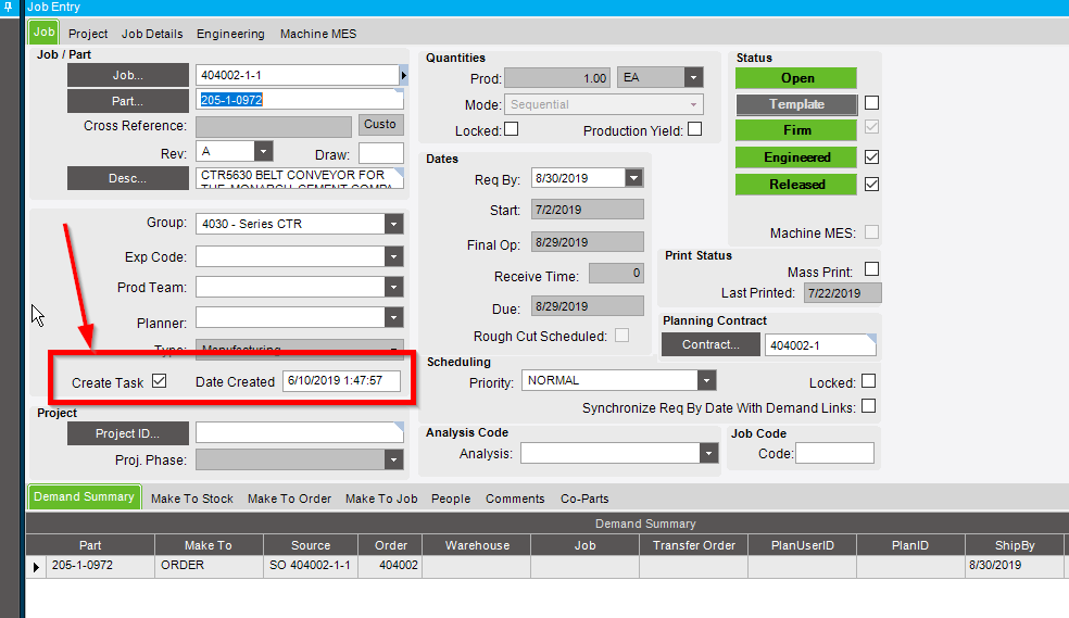

I would approach that by adding UD fields to the JobHead table, (a date and a check box), then hang a BPM on whatever process you are using to print the report and then update that date, and set the checkbox to true.
I have something similar for sending a rest call out to our task management platform to create a task. (except the checkbox is what sends it)

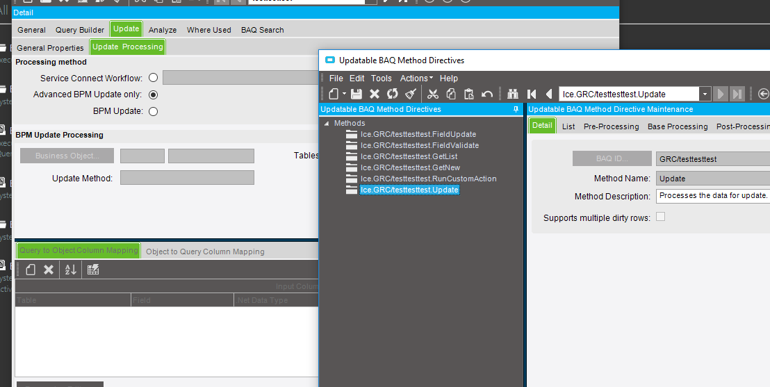

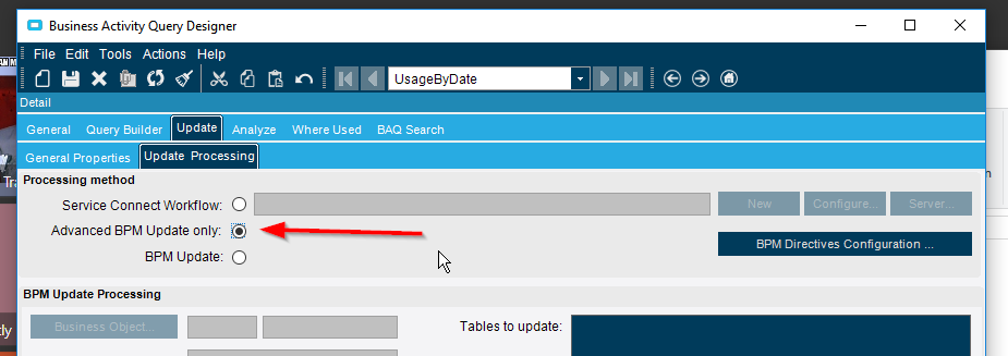

Put a BPM in the BAQ to make the update.
So would I have to make the baq updatable?
Yup, but you pick advanced BPM only.
My man!
I’ll have to try it out in test and see if I can figure it all out. Never tried that before.
I assume I’ll have access to the baq dataset?
Once you figure it out, it opens up a whole new world of possibilities. You can make UBAQ’s that you call using DynamicQueryAdapter so you can put all of your fancy logic server side.
Yes.

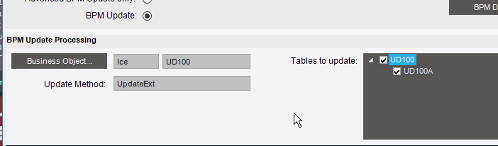

I will warn you though that the JobEntryBO can be kind of slow if you attach the fields to JobHead. I’ve made solutions where I just used a UD table and duplicated the necessary header info. It made things much faster since the UD tables don’t have any rules on them.
Interesting…
If are using a UD table, you can do a regular UBAQ with the BO like this. You can just make the UD table join a left one, so if there isn’t a matching record, you can make a new row. Not sure how that would work with the report though…
