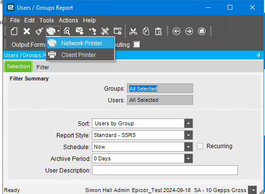

Just clarifying here, and I undetstand the printer is installed locally on the users pc…
But when the click on the printer icon do they select network printer or client printer? If client then they select the printer from a list of printers on their pc, if using network then the list of printer will come from printer maintenance. If the printer is not installed on the same server that the app server is running on it will not print. Furthermore it has to be installed in the user profile that is executing the app server is running as. As well, print preview will always give you a list of the client installed printers.
