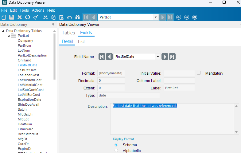

Hey Beth!
We use the PartLot.FirstRefDate to sort the order of the lots. That way, we didn’t have to build any intelligence into the Lot Number.
This is also what I was about to chime in with! Nice Mark!
