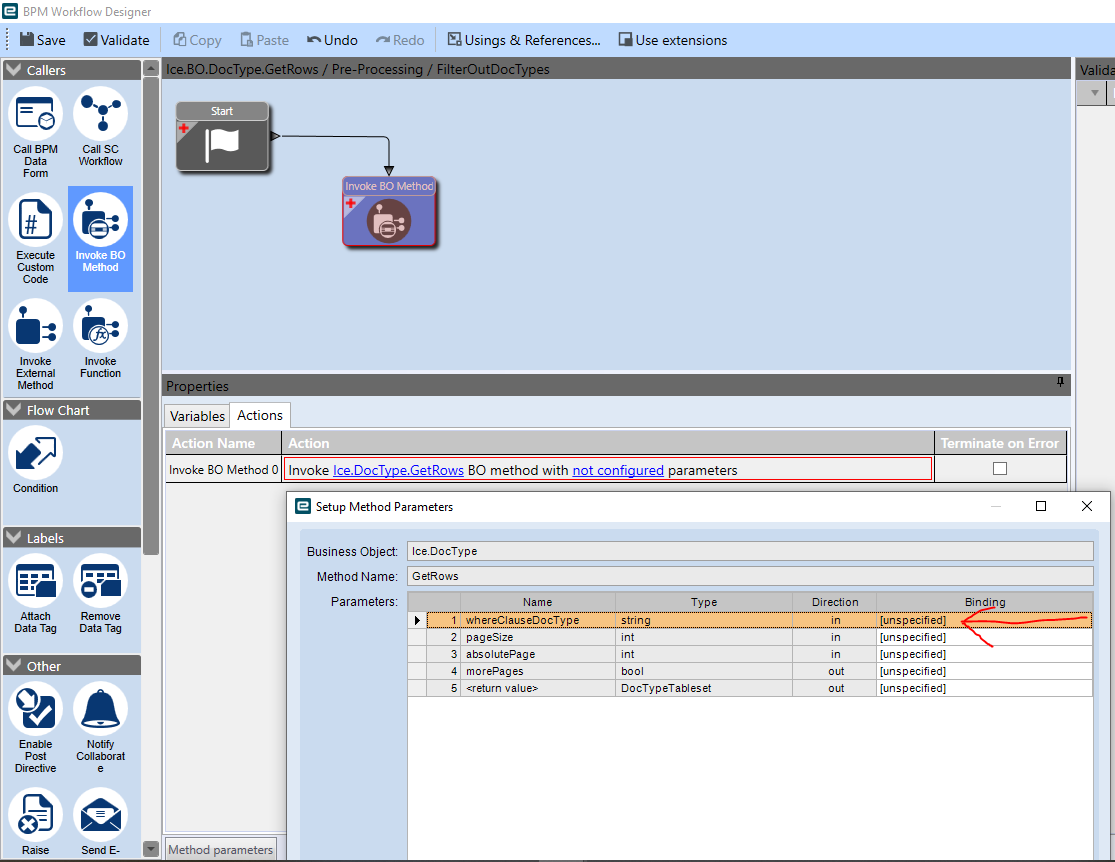

I’m looking for help to filter out the Doc Type dropdown menu off of Case Entry > Attachments. I have been trying to learn how to do this correctly and can’t figure it out.
I think a pre-processing Method Directive is what I can use, and I’ve done the trace logging to find the Ice.DocType.GetRows that I believe is being called when the user clicks the New button on Case Entry > Attachments. But from there I can’t get it right. I’m in the BPM Workflow Designer now, and I’m not sure which widget to use to accomplish this.
Right now, I’ve got Invoke BO Method up and I was thinking I could filter the where clause from in here maybe on line 1 or 5? But honestly, I am guessing. Can someone point me in the right direction, please, for this exact issue? I’ve read all the user guides and taken the ELC courses, but I’m not finding anything close enough to this example to mimic.

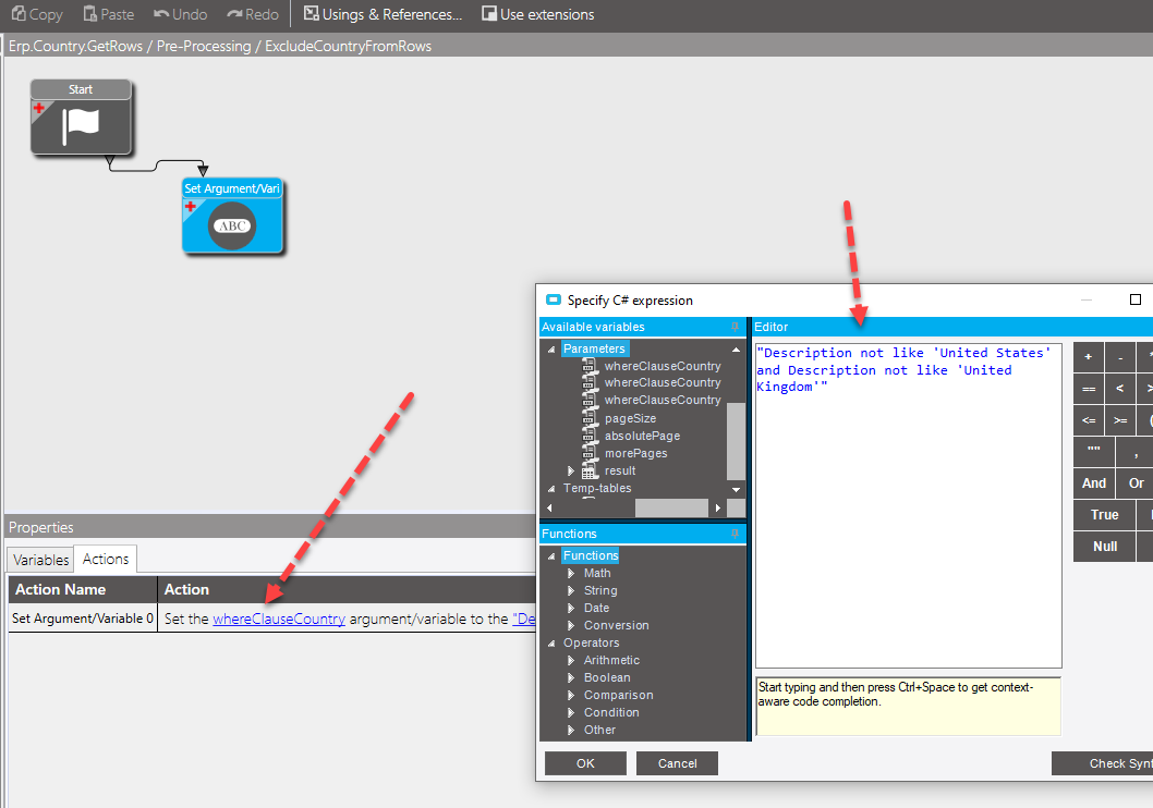

You might try setting the whereClausDocType parameter to a statement, much like SQL. I do something similar in a BPM to exclude certain results from the method return. My example is a little straightforward, but you might find some inspiration from it.
