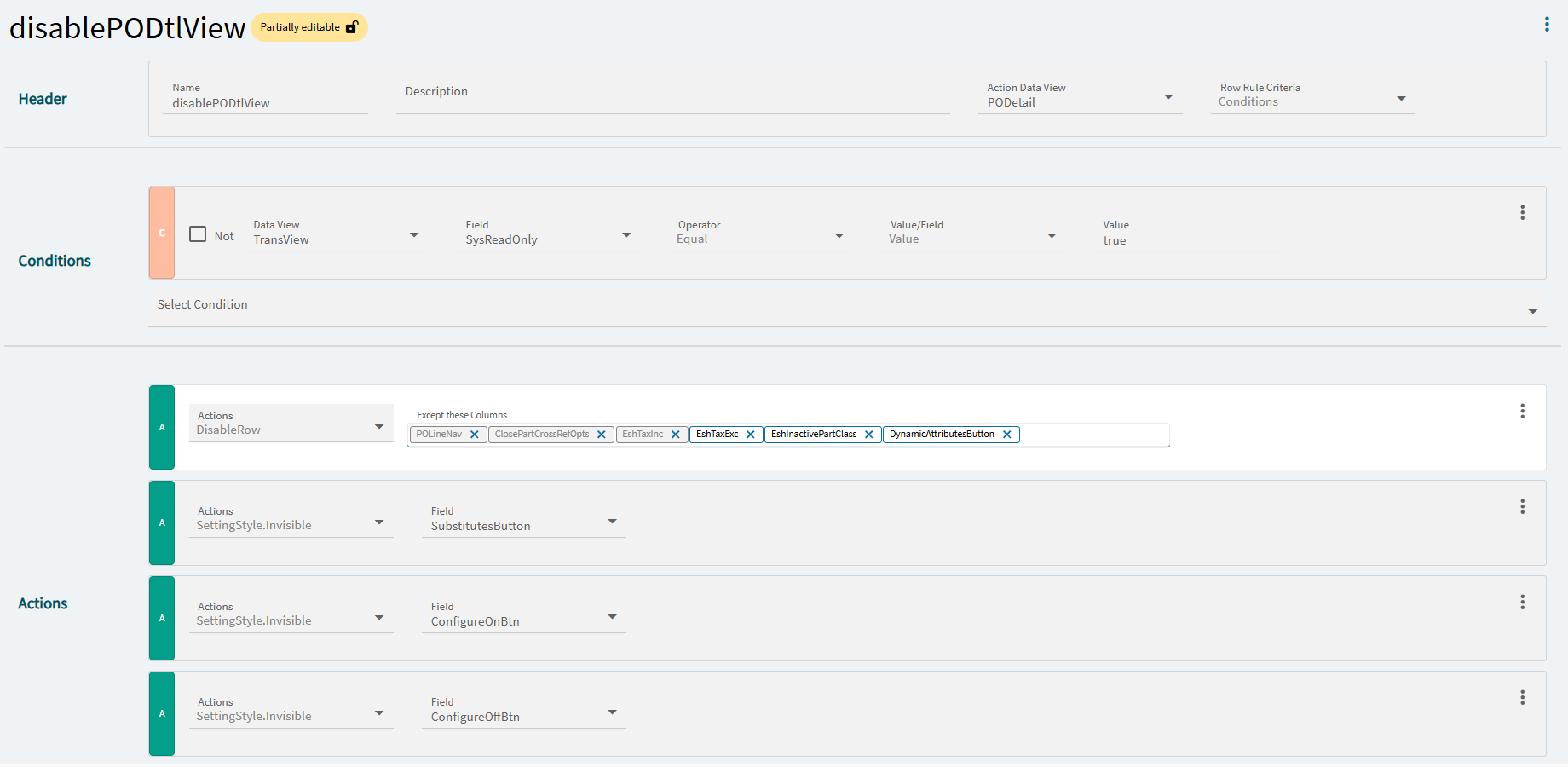

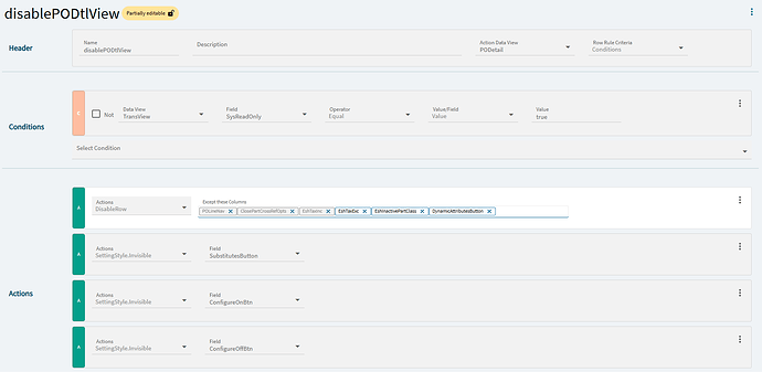

Here’s an example:
If TransView.ReadOnly equals a value of true… disable rows on the Action Data View.
You can even cherry pick specific columns you may want to leave active if you want SOME functionality to survive.
