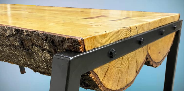

You jest, but I’m finally getting my shop cleaned and I can weld and do woodwork…
Looks like a plan!
