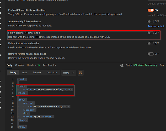

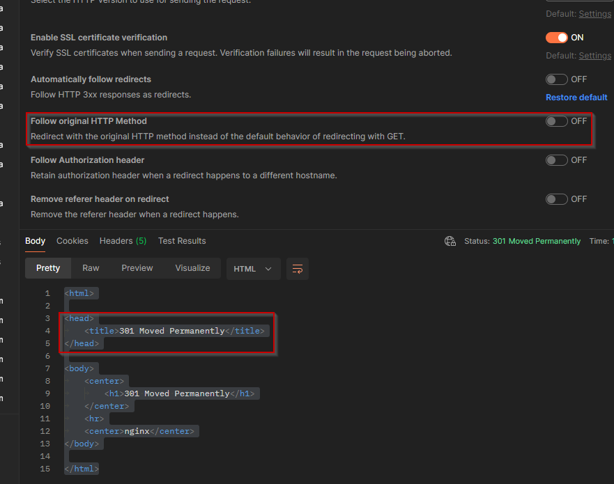

Checked with postman, i have no knowledge here, but the result i guess says that it has been redirected?
Yes that looks like a redirect to me. Change the endpoint to where ever it’s moved too.
Dropping the auth header is expected behaviour in .net if it hits a redirect.
