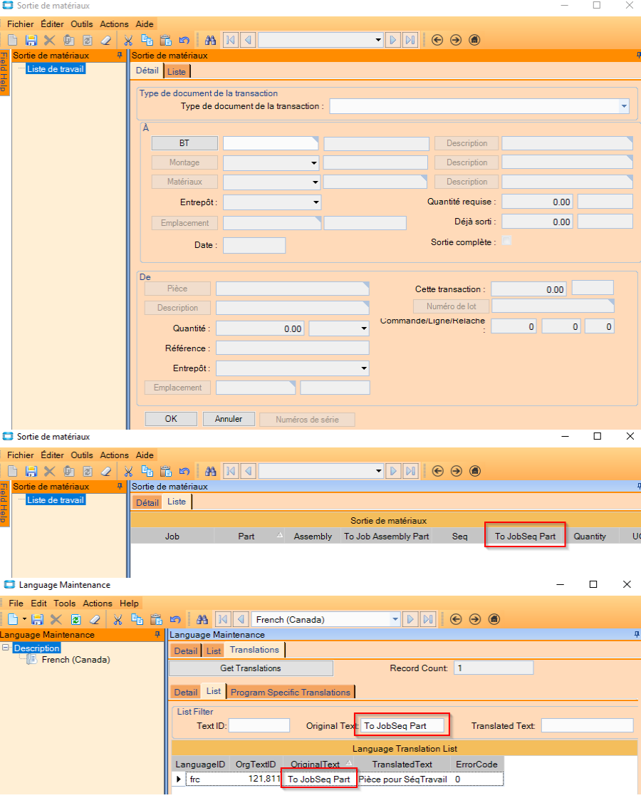

I’m a translator for a company that uses E10. They installed a French module into their version of Epicor which allows users to switch between the English and French versions. One of my responsibilities involves going through their different menus and ensuring that the French version is both accurate and displaying properly. For the most part, everything is fine and the “Language Maintenance” menu is working as expected. However, I did notice some menus where the French version of column names does not display (from what I can tell, the information simply isn’t getting pulled into those fields) even though the English version of those columns does have an associated French translation.
Since, as a new user, I can only include 1 image per post, I put three screenshots in the same image. Hopefully this is not against the rules in some way. The top part is a screenshot of a menu that is pulling the French translations properly. The middle part is a screenshot of a menu that isn’t. Finally, the bottom part is from the “Language Maintenance” menu, to show that the column highlighted in red in the middle part does have a translation attached to it. I also chose a field name that is unique, to show that it could not be a similarly named field that I am confusing it with.
I am baffled as to what is preventing the second menu from pulling the French translation like the first menu does. Any help would be greatly appreciated.

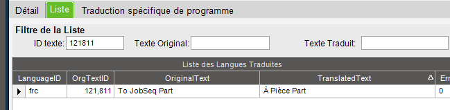

I verified our language id 121811 and I get the following:
Mind you the translated text does not seem to be very helpful…:thinking:
but the table columns do show as specified…

Thank you for your response, Pierre.
My version is 10.1.400.17 so I guess it’s possible that that’s part of the problem.
I did modify that value in the Language Maintenance menu, but even the default translation (which as you say, is not very helpful) does not display in the column field of the other menu. Still, I’m grateful that you were able to confirm that it is possible for the column names to display properly, at least for some users and on some version of E10.
