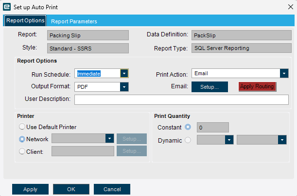

Below are the options I selected for Auto Print:
Any help is truly appreciated.

I haven’t used auto print, but I’m confused why the PackNum is 0 constant?
That’s because I was blind and it didn’t register that it was doing that, lol.
I changed it to the Packnum and now it emails but I have have another issue.
It emails the ‘Standard - SSRS’ report instead of the custom one called ‘MPD’ and is style number 1001.
I checked in the Selected Options->Report Parameters and the StyleNumExt is set to 1001.
Is there somewhere else to set this to select the Style Number 1001?

I’m on Kinetic View, and there are 3 things I can set on the AutoPrint widget. The first let’s me search all reports and I pick the one with the Report Style I want. See screenshot.
The next configurable link is the more like the options I’m seeing from your screenshot.

I had to set the PackNum in selected options (Thought that would have defaulted to PackNum instead of 0).
Then I had to select the correct PackSlip Report. My problem was, I didn’t see the MPD report in the company I was in.
I rebuilt this BPM in the company I was in when I created the MPD report style and now I can see it as an option.
I tested and it is sending the correct report style now.
I appreciate you working through this with me. I didn’t know the report styles were tied to specific companies…
