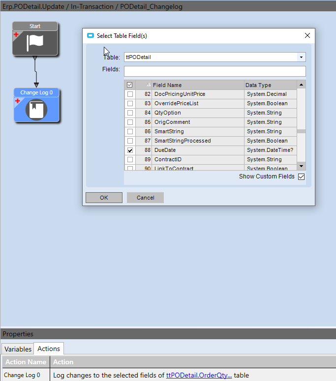

You can enable the changelog bpm for customer table. It will be accessible in the UI.
