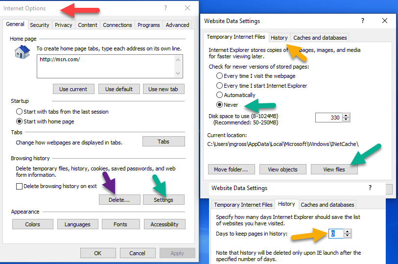

We fixed it by going to the browser that Epicor was actually using (internet explorer) and clearing the cookies. We just didn’t think about that browser, cause no one uses it.
Thanks @Banderson !! You gave me a clue and it worked for me as well!
First - delete all the history (purple arrow) - that itself didn’t work, or I didn’t wait long enough because when I opened Epicor and tired Help - it still gave me an error.
Second - Green Arrows - go through and set ā€œNeverā€ to prevent new files being created, and then go to View Files - this opens File Explorer - select all the files and delete them. Strange thing I noticed is that the Epicor Cookies were still here, even though I deleted them in step 1…
Third - Yellow arrow - I went and set the ā€˜History’ to be zero days just in case…
Then, all of a sudden, the Help Screen that was still open with the error, refreshed and it worked!!!
