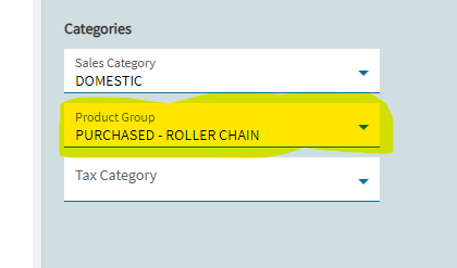

We are running Epicor 2025.1.11 and I am needing to make the Product Group field in Sales Order Entry a required field. I am trying to do it in Application Studio but having no luck. Any help would be greatly appreciated.

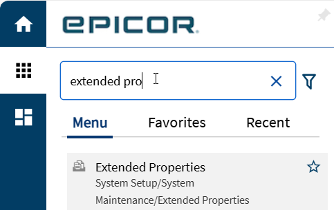

Just type it in the menu search…

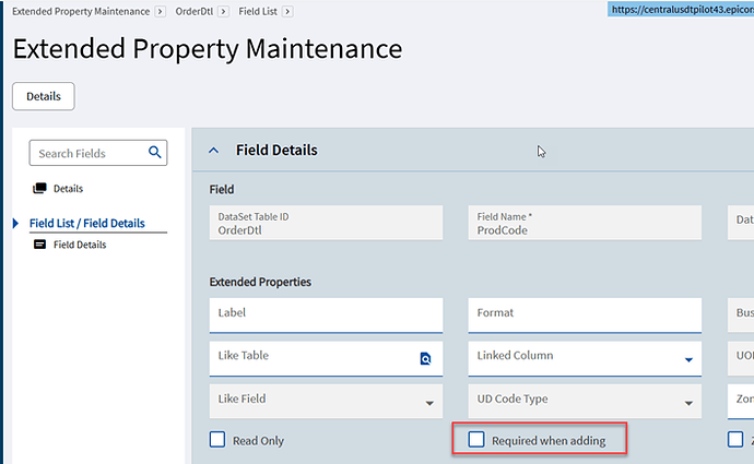

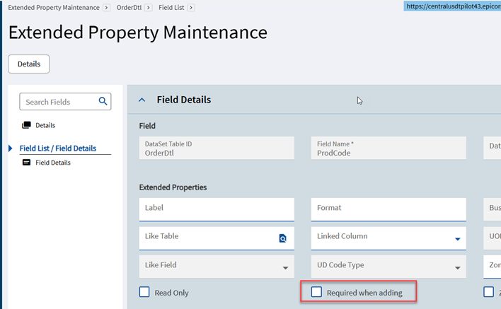

In Ext Prop you need to select the table first, so that’d be the OrderDtl table. Then the field you want, ProdCode. Then on the field’s Detail page you can set “Required when adding”

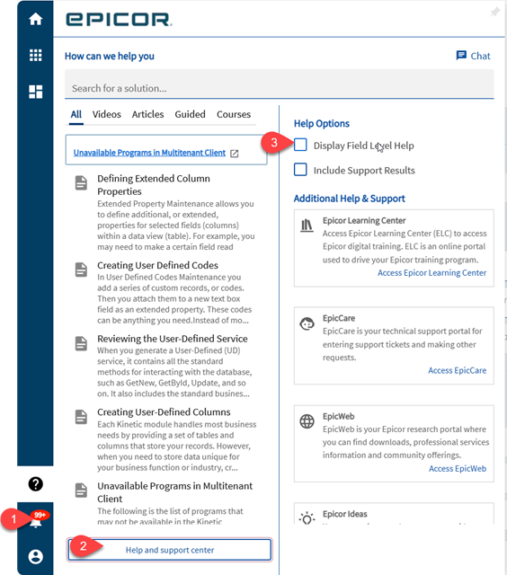

You can also activate Field help to learn what table & field are.
