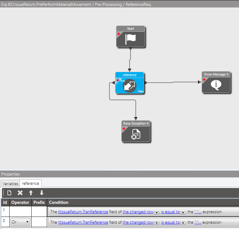

Currently, I want to require the reference field when Issuing/Returning materials.

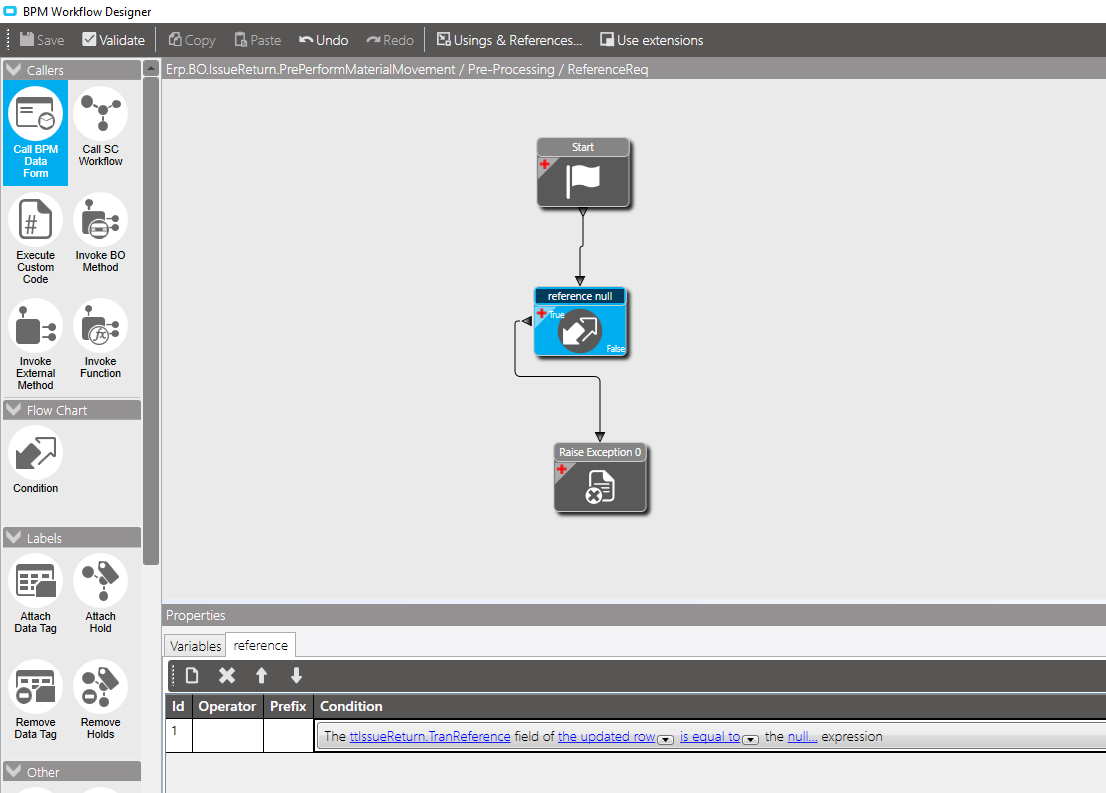

I believe this needs to be done with an exception through a method directive. I ran the trace log and I am using this screen shot. I have tried several variations with pre and base processing with transreference being null, but to no avail.
In general, I am not 100% clear on the difference between changed/updated rows and when to use all rows with method and data directives.
Thanks for all your help. I had a space between the quote marks. No space between them and it works. The show message is helpful, I had never used it before for debugging. Thanks
