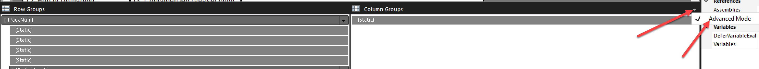

Shawn, to see the settings I showed on my screenshot you have to enable “Advanced Mode”:
That is how you edit properties specifically about the Tablix rows themselves (and not just the rectangles or textboxes that may be in the rows).
