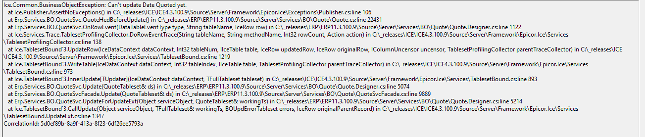

I have an updatable baq of quote info that works well. In my dashboard it gives me the above error, but I am not trying to update any dates. Thank you in advance.
Are you trying to mark the Quote as “Quoted”? I think the Date Quoted updates automatically when that checkbox is set to true. I would open that quote in Opportunity / Quote Entry and see what happens if you check the Quoted checkbox directly in the module.
No, I have a UD field called rating that I am trying to update.
Looks like the quote you are trying to update is already quoted.
Check if the error comes up for non-quoted quotes too?
What fields do you have flagged as “Updatable” in the BAQ?
Rating (a UD field), expiration date, followUp Date, and quote comment
Expiration Date is connected to Date Quoted. Could that have anything to do with it? Do you have anything that adjusts Expiration Date based on what the Rating is?
No
