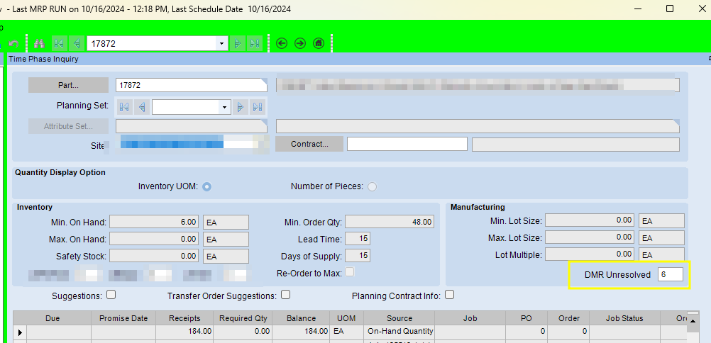

Here is BPM for showing Inventory in DMR
We decided we wanted to know the QTY in DMR during time phase.
I created a Customization on Time Phase and a Method Directive BPM.
This works with multiple DMR for same PN and sum’s all the Qty.
Attached is BAQ showing DMR Qty for TotDiscrepantQty, TotRejectedQty, totalAcceptedQty and a calculated field for validating.
totalDiscrepantQty - (totalRejectedQty + totalAcceptedQty)
I used this to verify my results.
kpDMRBins.baq (14.3 KB)
Optional message pop-up for debug.
Create a Text Box in customization and bind to
callContextBpmData.Number06
Method directive - Post Processing
Erp.BO.TimePhas.GoProcessTimePhase
10-17-24
This uses BPM CallToContext Number06 - Change if needed

        // Create a formatted message with the sums if using Pop-up message
        string message = $"PartNum: {ttTimePhas.PartNum}, TotDiscrepantQty: {totalDiscrepantQty}, TotRejectedQty: {totalRejectedQty}, TotAcceptedQty: {totalAcceptedQty}\n";
        // Concatenate the formatted message to the 'combinedMessage' string
        combinedMessage += message;
        // Store ONH Value for BPM CallToContext Number06 | DMR Total - (Rejec + Accepted) to show remaining in DMR
        callContextBpmData.Number06 = totalDiscrepantQty - (totalRejectedQty + totalAcceptedQty);
