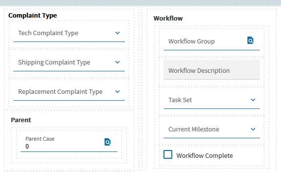

I’m looking to have a set of 3 combo boxes to have different options but to save to the same field… *only one of the 3 combo boxes will show based on what is set to a different field… does anyone know a way to achieve this?
Jerad, can you provide some more context on this?
Really my end goal is to have a combo box’s values in its list to be different based off of what is selected in a different field…
My first thought was to create 3 combo boxes… all saved to the same field.
ComplaintType_c
And i would only show one of them based off another selection.

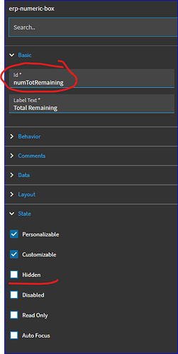

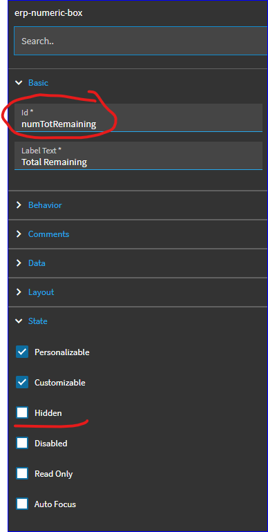

You can change control properties via event and property-set widgets.
Use your component’s ID… you could set their default state to be Hidden.

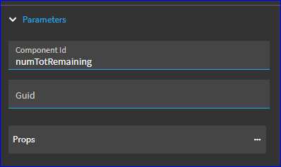

Then in an event, based on a user selection in your first control (so, an on column changed event, perhaps), add a property-set widget.
Put your control’s ID here:

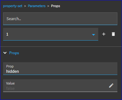

Add a property like below to change the hidden property to false:
Thanks again… i will try this out… is there a unhide prop?
Meaning if i defaulted all 3 to hidden but only showed the correct one based off a event?
well… the property is “hidden”… So you can play with both sides of that boolean.
If you set that to TRUE, then its hidden.
If you set it to FALSE, then it will be visible.
