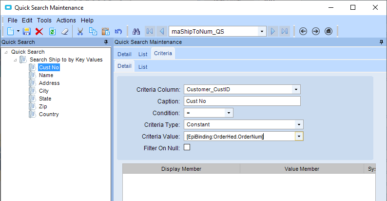

Thanks Tim. Your response looks like it belongs with my previous post about passing parameters from a QS to a BAQ, but then again, that proves the point that they are equally similar and can only be done via programming. In my conversations with some of the TSG developers, E11/Kinetic is replacing much of the free-form coding ability with “canned” functions. Perhaps at some point in the future, Epicor would allow us to pass something like [EpiBinding:OrderHed.OrderNum] as a constant:

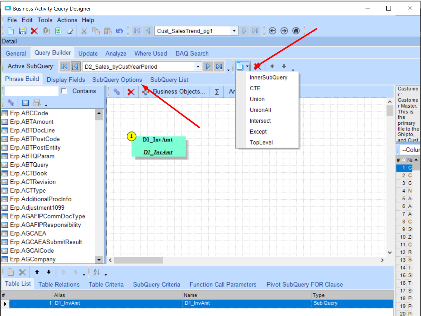

Hi Tony,
May I suggest that in your BAQ, change the Top Level query (the one that displays the data) into a subquery.
Make a new Top Level query (in the BAQ) that gets its data from the subquery, and use this to display the data you want. Subqueries are added on the Phrase Build page and TL and Subqueries are changed at Subquery Options. ( subqueries are easy to use and provide a lot of power and flexibility).
