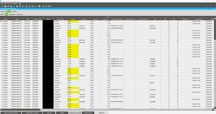

Yes sir, have already been sifting through those. Problem is, because I’m so new, I have only encountered 2-3 “issues” and don’t have a wide field of view on what has happened previously as well as if they have been resolved or not. One for example is our hourly labor employee’s time clock in time for production jobs. We currently have company configuration to track idle time for when labor workers are clocked in but doing something other than production on a certain Job #. When they first clock in, in the morning using “indirect production” it will incorrectly time stamp their hours saying they clocked in at 12AM. Once they clock into a job #, it accurately time stamps stating 10:38-1:15pm. They will also be able to clock back to “Indirect Production” after a job and it will then accurately track their time stamp. It will always correctly track the total number of hours clocked in, but just not the accurate time stamp if they clock in using “indirect production” in the morning. This does not occur if they clock into a job first thing. I have figured out it’s due to the Calc idle time but haven’t found a solution yet and was told this feature was fixed in “later” versions.
The “Calc Idle Time” functionality only actually records a number of hours… not the time that those recorded hours took place. Their LaborHed record will record the daily clockin time… each employee with have a single LaborHed record (that records timeclock clockin and clockout) and multiple LaborDtl records (one for each job clocked into, and one that holds the Idle time.
This isn’t a bug, it’s a feature. It’s also a pain in the butt to figure out!

Epicor doesn’t work that way, and never has (at least since Vantage 5). If you want an actual timestamp then your employees will need to clock into either a Production or an Indirect activity.
What you’re saying is, I need to create an Indirect activity for users to clock into instead of just indirect production. For instance, the receptionist would clock into “office calls”, a shop employee would clock into “shop work”, etc. Essentially creating a job for them to clock into that is not a production job #.
It’s actually an Indirect Labor Code (not a job) and these codes can be set to hit specific GL accounts.
Alternatively, if you don’t want to track idle time for anyone else, you can just use the LaborHed record (that is automagically created on clock in) that has both the ClockIn and ClockOut times, and set their EmpID up with the appropriate GL control.
Typically, Payroll-type time recording utilizes the LaborHed table precisely for that reason (1 record per employee workday). Earned Hours and other production-related time recording utilizes the LaborDtl table (multiple records per employee per day).

The clock in and clock out times are stored in the labor head table… the idle time is a calculation based on any time that they were not clocked into work… If you want to know when they clocked in/out of the system, look at Labor Header. the individual details in Labor Detail is typically accurate for start/stop of actual work.
