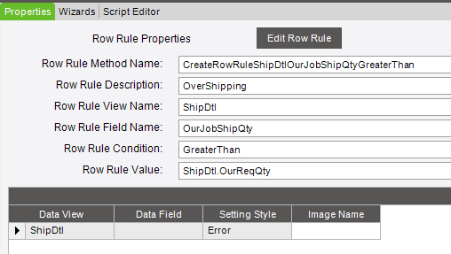

In classic we had a very simple over shipment highlight rule that would help our team from mis keying or overshipping a line in customer shipment entry.

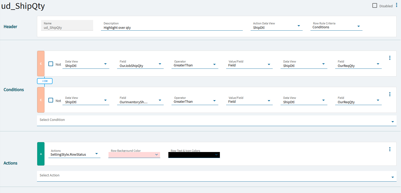

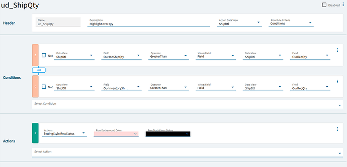

We recreated this same logic in application studio but it will not highlight the line under these conditions.
Am I missing an additional step that needs to happen in order to trigger the data rule in Kinetic?
As always - all help is greatly appreciated.
Maybe get out of App Studio and come back in? Delete the rule and rebuild it? :person_shrugging:

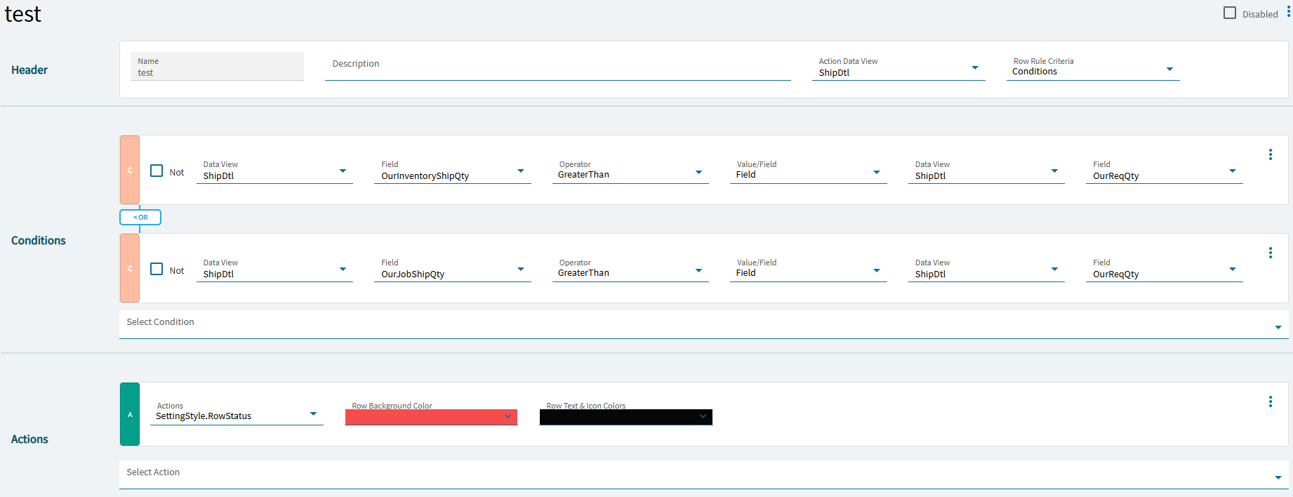

Your exact setup works for me:

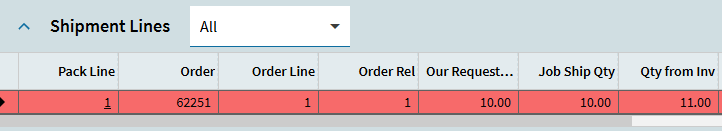

Preview:
Deleted it and reentered it. It works now. Thank you!
