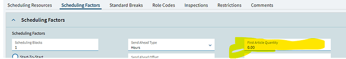

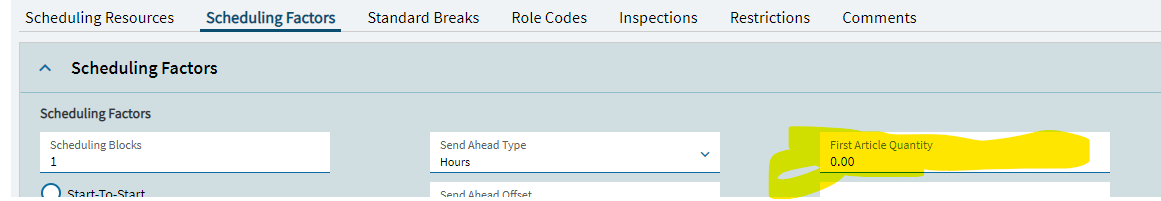

If you use the FAIR functionality, it will not let an employee log into the Production operation. It is very specific though, in that you must do a Setup activity. If you don’t do setup, the functionality does not work.
How would we go about setting this up so we can test it, this is a new part of Epicor i did not know about are there documents on this?
Thank you
Yes, it is documented. The field is on an Operation. You can enter it on either the MOM or on a job.
