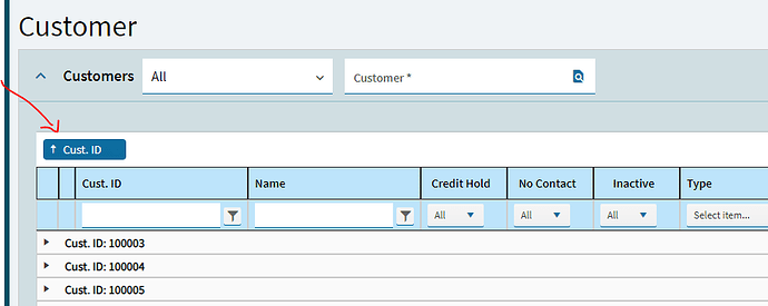

I don’t see any way to remove that group if I add it:
The only way is to refresh the whole page for it to be removed. However, if for example I clicked on ‘Save Layout’ on my grid, the group is stuck there and I can’t find any way to remove it

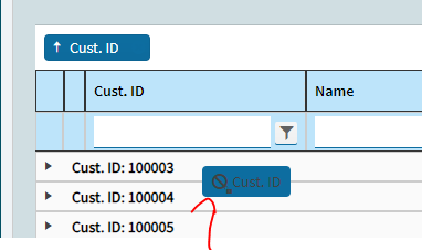

Is it a bug or am I just dumb and can’t figure it out? I thought that simply dragging it to the grid would remove it but I always get this icon and it does nothing:

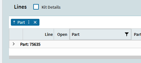

Try clicking where the “x” is in the below:

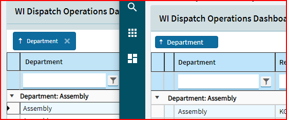

Here’s an example which DOES show the “x”:
But, again, there was a previous issue (in previous version(s)?) where it wasn’t visible.
I just found my answer on another thread but the X is invisible and you should just click anywhere right of the name of the field and hope to find it… Not sure if it’s fixed in a more recent version but it’s weird that it disappeared like that. It’s there in my example:

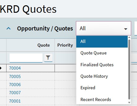

I am attaching an example of how we are using the grid to pre-sort some scenarios for us in quotes and orders. This has been helpful for our account specialists (crm-related).
Screenshot 2025-04-29 103645
