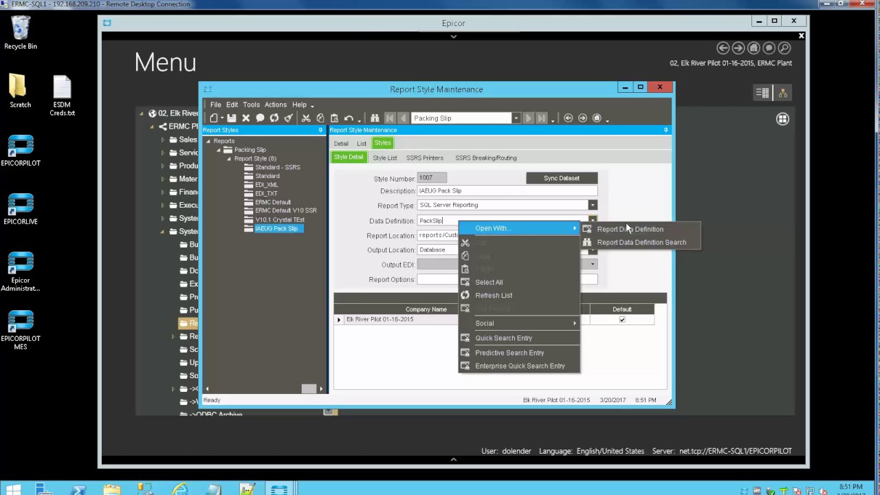

  1. Go to Report Style Maintenance > Styles > Style Detail > Detail
  2. Rigth clic on Data Definition (ARAgng) open with Report Data Defitinion
