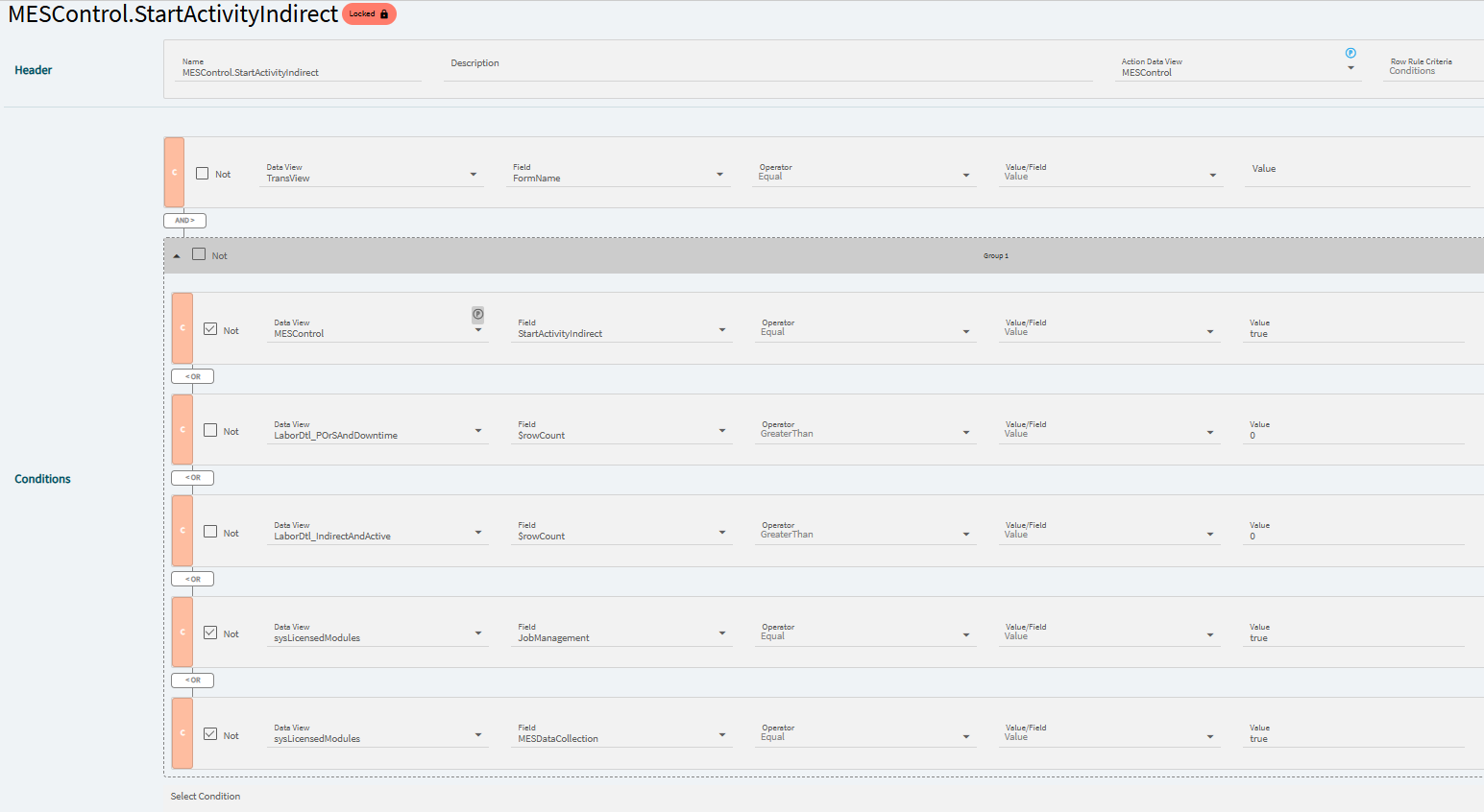

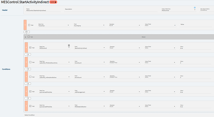

Is your form customized at all? Just curious if, you’re not using indirect labor entries currently, somebody customized the form to disable the button.
There is also a data rule on the form that disables the button based on various criteria. Possible one of those conditions are true in your case?
