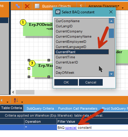

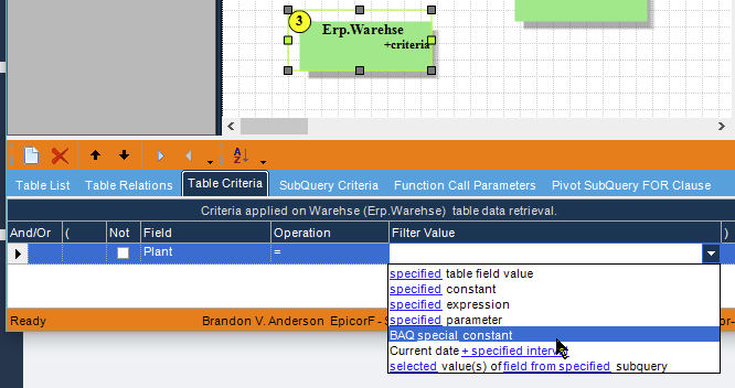

In your BAQ you can filter the table(s) by current site. Add a filter to the table on the Plant field, and choose the BAQ Constant. That will filter your results by the the site that you are logged into.

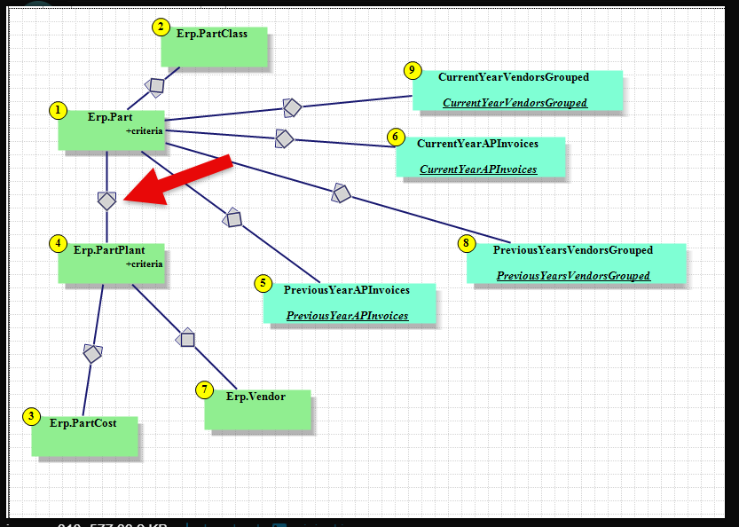

I added the parameter Plant = BAQ CurrentPlant constant to all applicable tables, but the Query still seems to bring in Part Numbers from the other site.
You’re gonna have to show me what you’re doing if you want me to help you here.

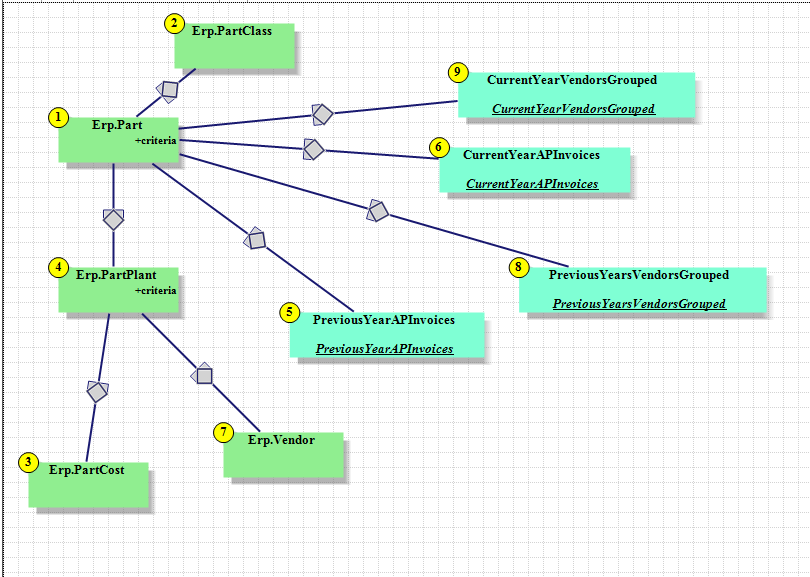

We have the Part Plant table in there and filtering on Current Plant. Is there something else we can do with that table?
Show your current BAQ
Are you sure there is no part plant record for the part?
If it’s all left joins, then you aren’t filtering. You need to inner join on partplant.
or, add it as a subquery criteria instead of a table criteria.
