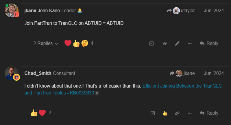

OK so doing a little bit of digging, I can join GAJrnDtl to TranGLC on ABTUID as discussed and I have then found that the field TranGLC.GLAccount brings up a format of

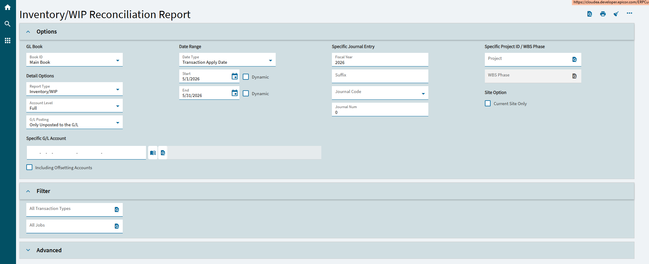

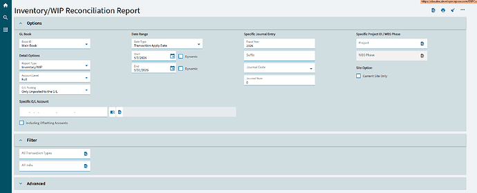

Another tool, is the Invnetory/WIP Reconciliation Report… it allows you to look at the GL by job, or to look at a specific GL account and see what hit it… or by transaction type, etc… it is very detailed.
Strangely enough it was from the chart tracker that the request started originally.
