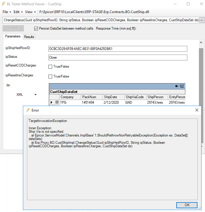

Hope its ok if I’m tagging on to this thread. I’m trying to change the status of a BPM and when I use this same method (after obtaining the sys row id) I get the following error:
Actually no, the larger routine deletes all lines, and if the pack is empty it should be closed/voided. I switched the status string to “Void” and that works. Thats good enough for this! I had originally wanted to use void anyways.
