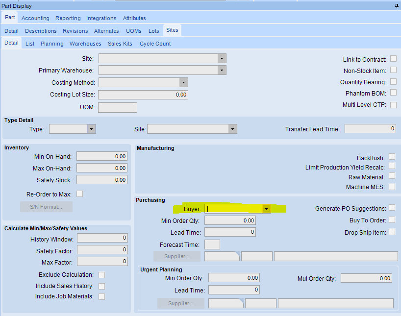

Part → Sites → Detail → Buyer?
PartPlant.BuyerID - update via DMT?
So it would be only associated via each part???
So no choice of configuring this via DMT…
Would have been 'nice to have ’ the option in site configuration as well as a global site default… then if specific part need a specific buyer… then PartPlant.BuyerID would be used…

If you’re doing site-specific buying then you might not have a choice. I checked Site Config and Warehouse…not there. Only other table I found it in so far is in Part Class…

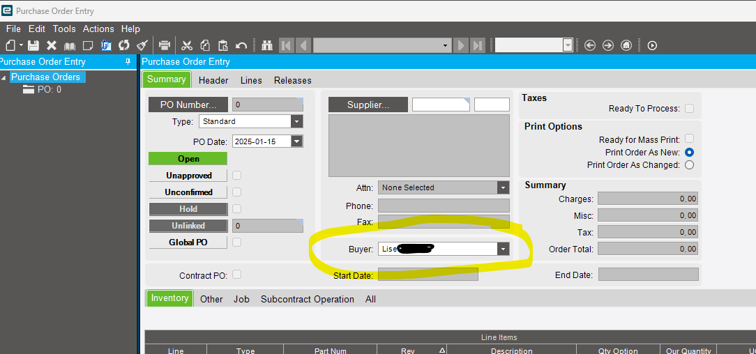

Well well … When I create a new PO, I have not yet selewcted my part to add to the PO.
There is a default buyer shwing in the Summary:
It is that buyer info I want to change, ideally by the current user (if it is a valid buyer of course)
I did add the part where a setup another buyer as default, but the summary buyer did not change…
So the PO header, by default I do not know where it is getting the info, but always has that specific buyer. Lise.
The user would like to be himself when he creates the Po… and not needing to change it manually afterwards…(cause he forgets often… )

That is exactly what happens !!!
