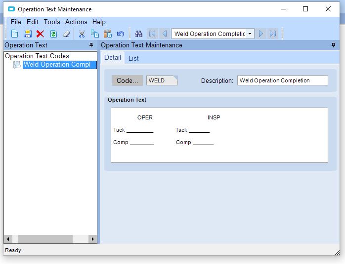

Have you looked into Operation Text Maintenance? The text defined here prints on the Job Traveler when selected for an operation.

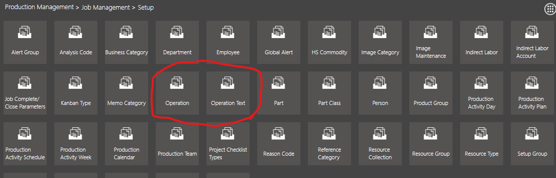

Depending on your role at the company you might not have access to it. The screens are called “Operation” and “Operation Text”. They are in Production Management > Scheduling > Setup

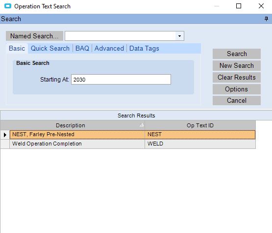

Oh wow small world, I’m just down the road in New Holstein, WI. You were right, I had to jump through some hoops to get access to operation/text. I just got in and I was able to find the weld operation and the associated text but I’m not able to find my machine operation. I’m not sure if I am searching correctly or if there’s something else going on. No matter what I search I am not able to pull up any operations besides these two.

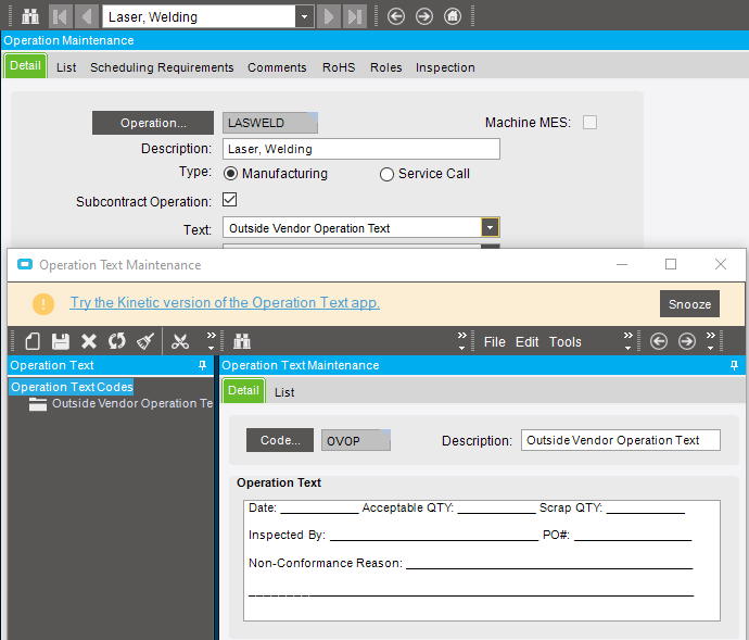

I think I got it figured out here, I had to go and create the new text code in Operation Text, then go find my specific op in Operation to apply the text.
