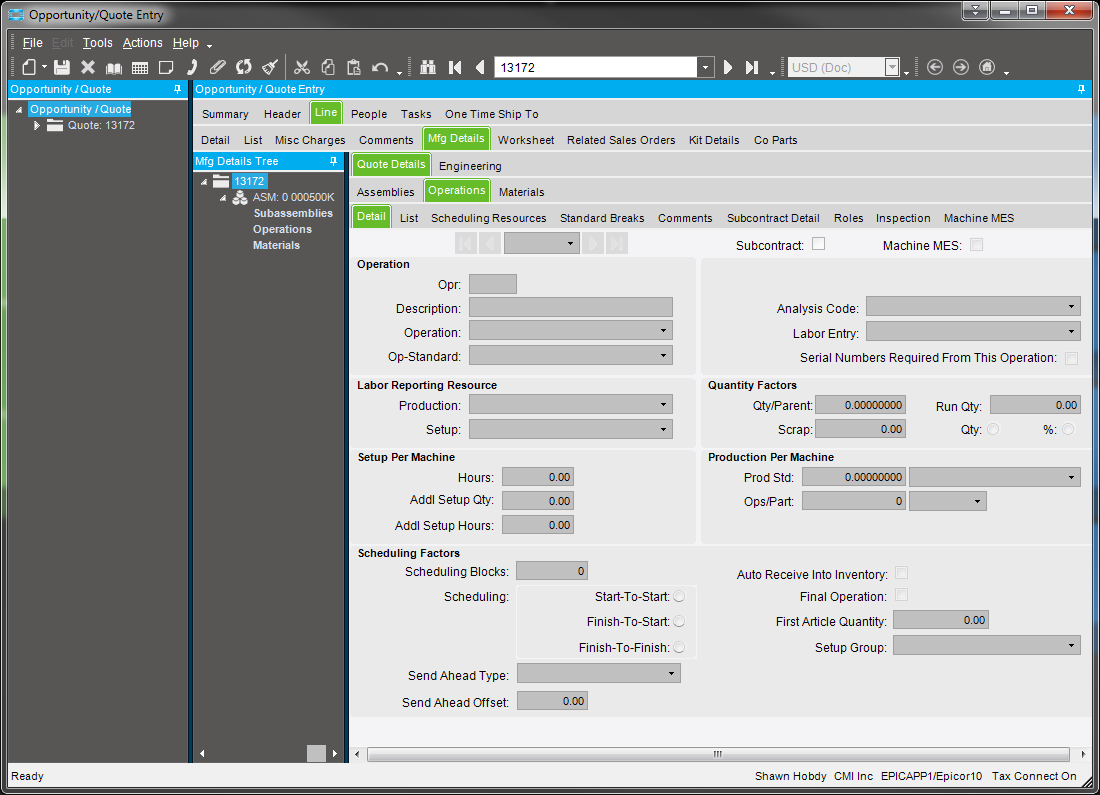

It is on the Line > Manufacturing > Revision Tab
@Kimberley
I don’t seem to have that particular tab. I am running 10.1.500.23. Here is what I got.

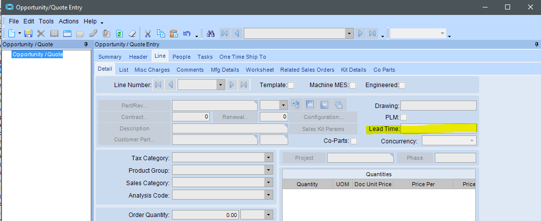

What tabs are under Line> Detail? I am guessing it is there somewhere.
It’s located here?
@tkoch
That one is QuoteDtl.LeadTime.
I need PartPlant.LeadTime to show.
That doesn’t get populated when a part is entered that has a lead time? The one @Kimberley suggested has the same EpiBinding

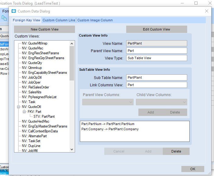

I tested and it doesn’t thought it would. A Foreign Key View will get you what you want.
@tkoch
No, they don’t populate from the PartPlant. The PartPlant.LeadTime is an int.
The QuoteDtl.LeadTime is a nvarchar.
I created a FKV to Part then a Sub Table View to PartPlant. The only problem I see with this is PartPlant is many to one with Part.
I agree you need do pull it in.
@tkoch
DUDE!!
You are my hero! It is working with the sub-table.
I will need to keep testing but so far it has pulled correctly for over a 100 lines in various quotes I have looked at.
Thank you very much! I really appreciate you answering me. I didn’t know you could do sub-tables.
