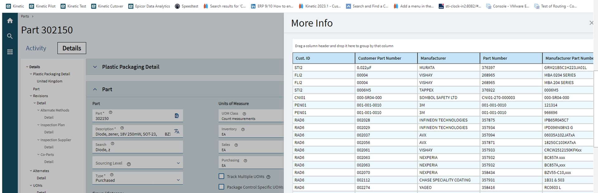

Sorry to Bump and old thread however i have an issue with the More Info ‘Zone BAQ’ solution in that my BAQ is set on the part table and pulls in any Manufacturers Details from the PartXRefMFG table and Customer Part Details from the CustXPrt table. It works fine if there are Manufacturers details for the part but if there are not it pulls though a list of all parts that have details in the BAQ. I would have expected a ‘no information available’ type message.

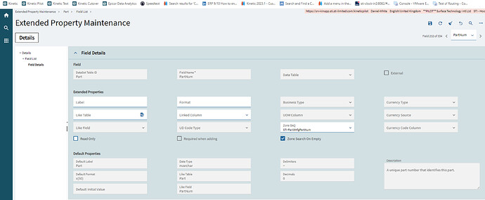

How did you setup your BAQ Zone? Extended Properties? Classic UI or Kinetic UI Customization?
A screenshot of where you have this setup and your BAQ might help, I’m not sure I understand how you have your BAQ setup. This might be an odd bug, so if I can replicate your setup I might be able to see if it’s setup wrong or something else.
STI-PartXMfgPartNum (2).baq (19.0 KB)
Extended Properties and BAQ uploaded

So try disabling ‘Zone Search on Empty’
Hi Rick,
I had it unticked originally. I have unticked again and tested on 2 parts, one which has MFG details and the other not

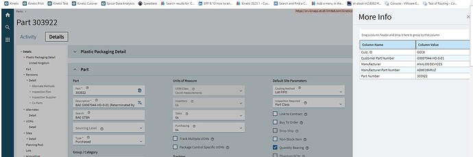

WITH
WITHOUT
