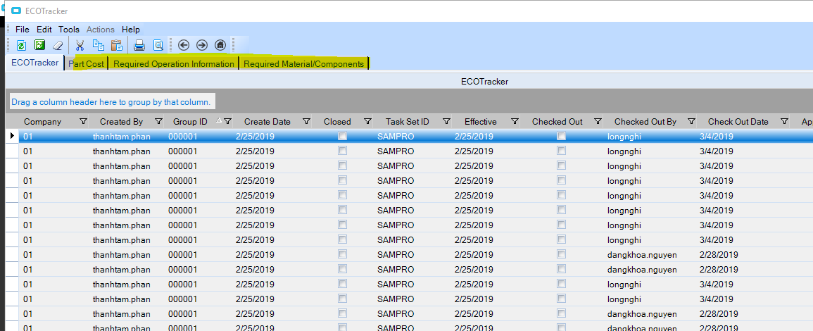

How do I customize the dashboard to hide 3 tabs or drag these 3 tabs to 1 sheet?

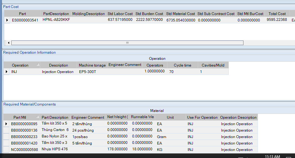

I want to edit the dashboard as show: sheet 1 (ECOTracker) one ECOTracker
sheet 2(Submited Info) contains 3 grids (Part Cost, Required Operation Information, Required Material/Components)

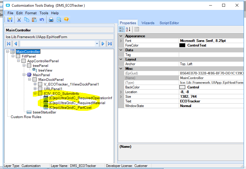

I can hide 3 tabs (Part Cost, Required Operation Information, Required Material/Components) and then add 1 sheet to drag into 3 gridviews to map data

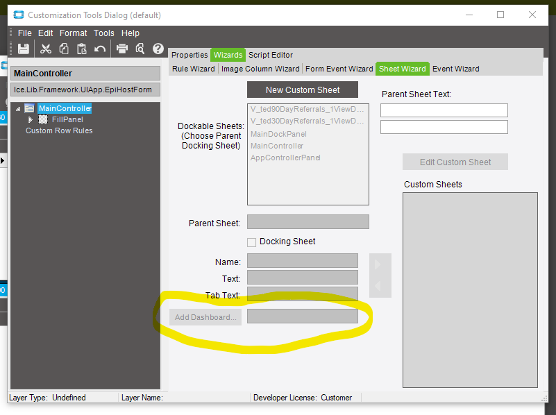

One solution would be to create a dashboard with just the first sheet. Then create a second dashboard with the other 3 sheets. You can then use a customization. Using the sheet wizard, you can then add the dashboard with 3 onto the first.
thank you, I also thought of this solution, creating 1 sheet after the first sheet and then placing 3 gridviews but the map data is quite complicated. I want a simpler solution

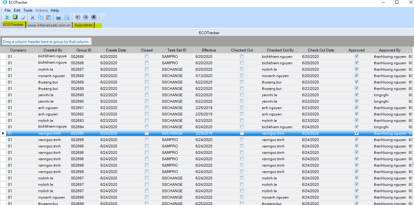

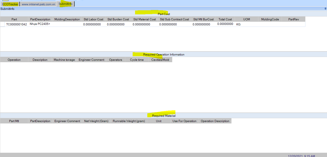

this is how i redesigned because i originally wanted to ask to use dashboar and gridview dashboar’s publish and Filter feature but have to do 3 different tabs?
