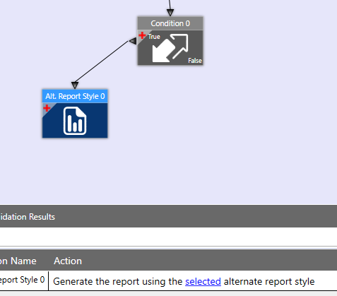

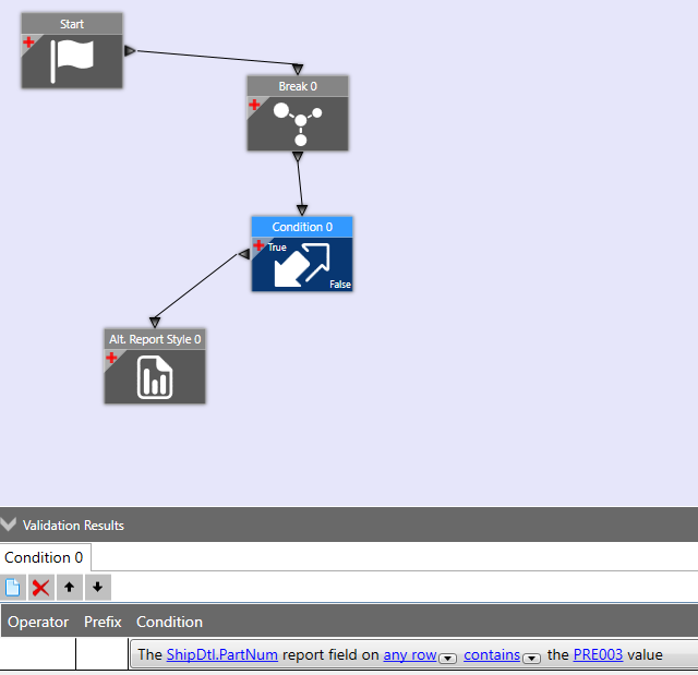

I’m not sure what your use case is, but it seems like this might be a use for Advanced Print Routing.
The goal of this is to automatically select report style 1007 if the part number contains PRE003 at the start.
I agree w/ @danvoss.

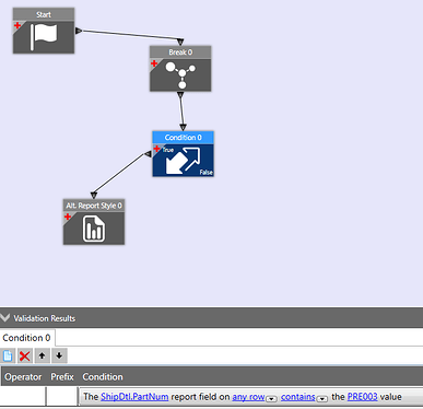

You could set up and test an APR like below:
If the Condition is “True” then you use the Alternate Report Style and set it to your 1007.
If “False” it would print the default style.
No code to trouble-shoot… so, may be worth testing.
Hello dcamlin,
This looks way more straightforward, however do I do this on the default report style or 1007?
The default.
It’ll print your special style when the criteria is met.
