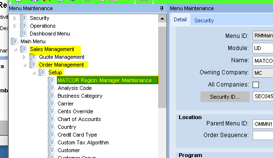

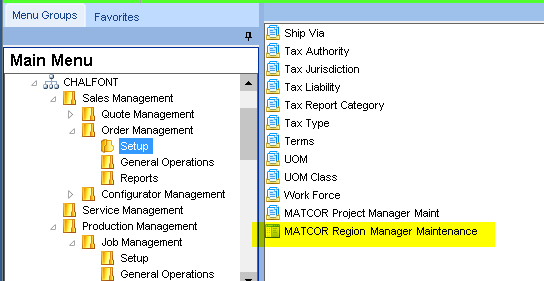

There might only be a menu entry for that UD table. For example, We use UD06 for our “Region Managers”. So we added a menu item under Sales Mngmnt -> Order Mngmnt -> Setup like:
The menu settings include:

Launching the menu item “Standard Messages”, will bring up a form that shows the UD01 data.
So look to the menu tree to see where “Standard Messages” is. In my example it’s
Now that you have found it on the menu, you are almost there… you now turn on customization mode, and then launch the menu option, which allows you to customize it.
