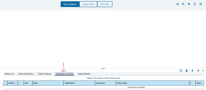

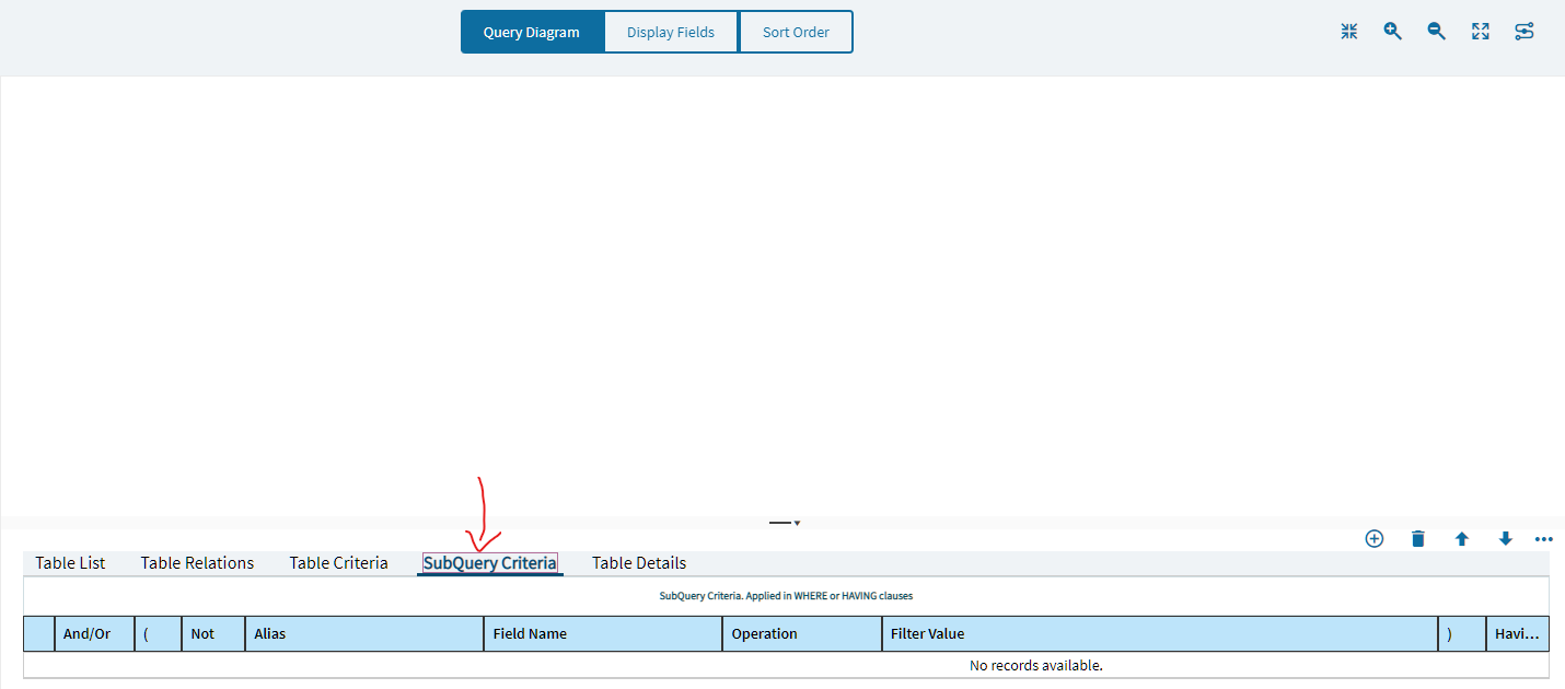

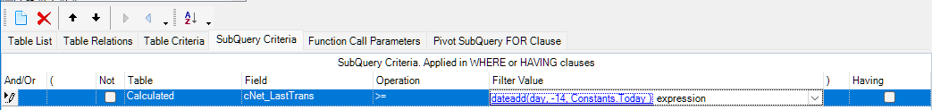

Something like this in the query where your LastDate is calculated. But replace the field name.
Is that using the Classic client form?
My screenshot was from classic just because I’m on-prem and I’m holding on to it for as long as I can.
It’s in Kinetic also.
Christian, at which level should the subquery criteria be at?
