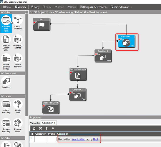

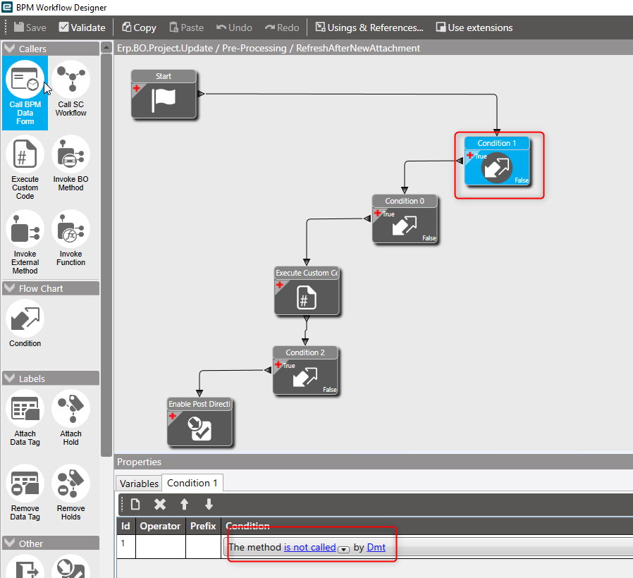

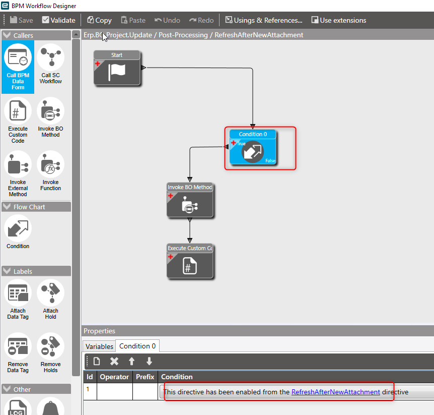

Step 4 : Pre-Proc and Post-Proc Method Directive to refresh the client data after the file upload
This step was overlooked, but hopefully we caught it before shit hit the fan. Steps 1-3 is all you need to make this thing work. But, the client is unaware that the filename has changed, so if a user tries to edit the file, corruption happens. So we need to create a BPM on update/Master update for all the BOs that might receive an attachment. Here is an example for Project :
And this nifty little line of code attach the tableSet that we just got from the GetByID to the transaction and sends it back to the client.
Finally, rinse and repeat for every BOs that might receive an attachment:
