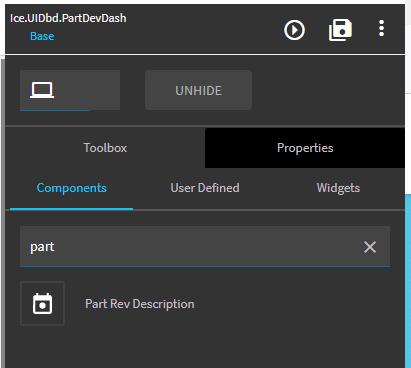

Looking for advice on using the Part Rev Description control on a Kinetic Dashboard.
I am hoping to use it as a Search for a dashboard to replace the Tracker view imported from a deployed dashboard using Dashboard Maint ( still have not figured out if you can start a blank Kinetic Dashboard yet)

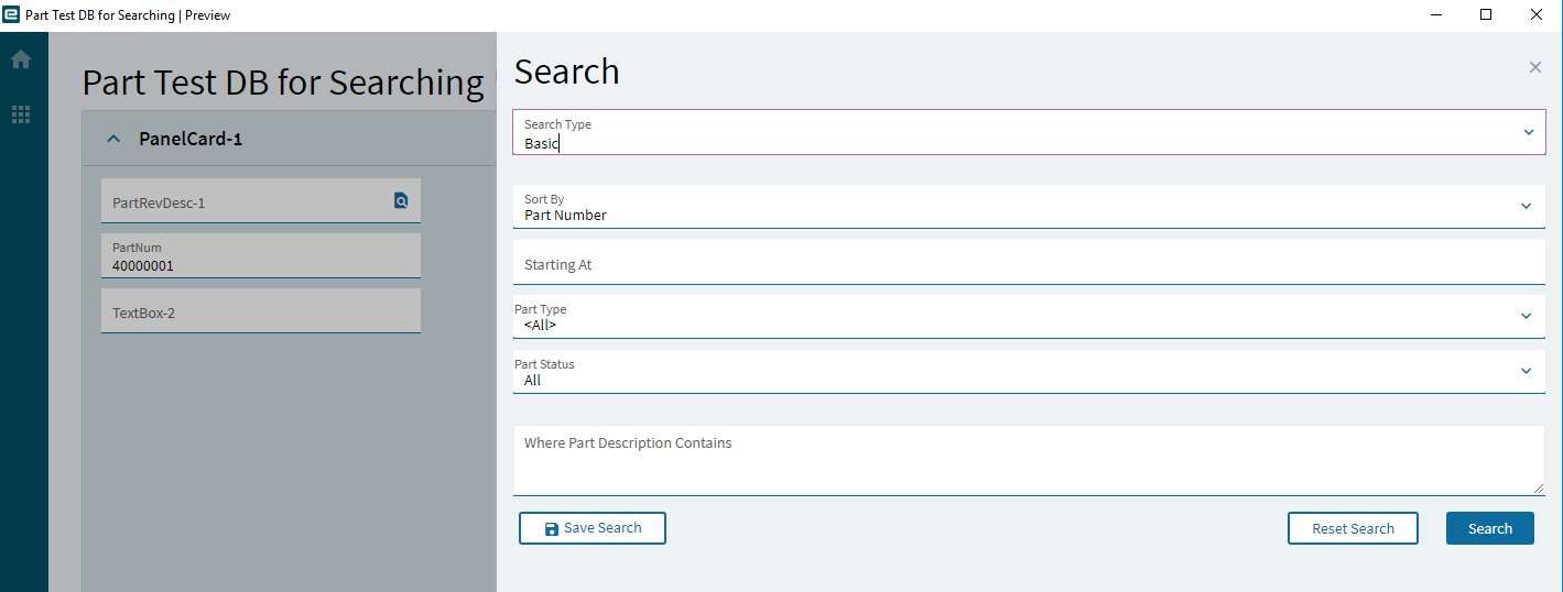

It ( the Part Rev Desc control opens up nicely to a slide out search panel

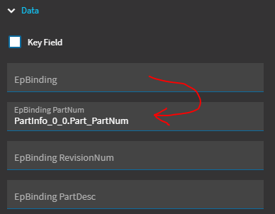

But… Here is where I am Stuck. How do I get the selected part to " stick " and return the data row ?

Think I figured it out… I was using the EP binding, not the EPBindingPartNum…
