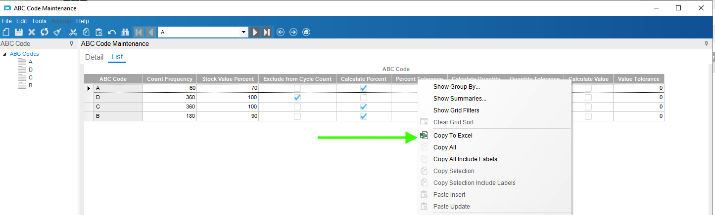

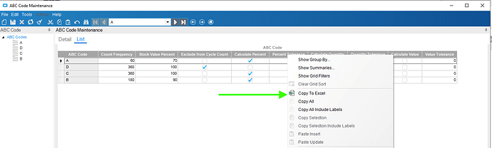

Not sure I have heard of that specific report, but what I have done is pull all the ABC Codes into the ABC Module, go to List, and right click at the top and send it to excel.

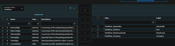

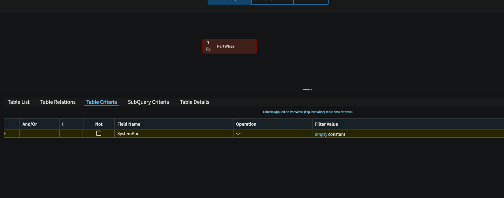

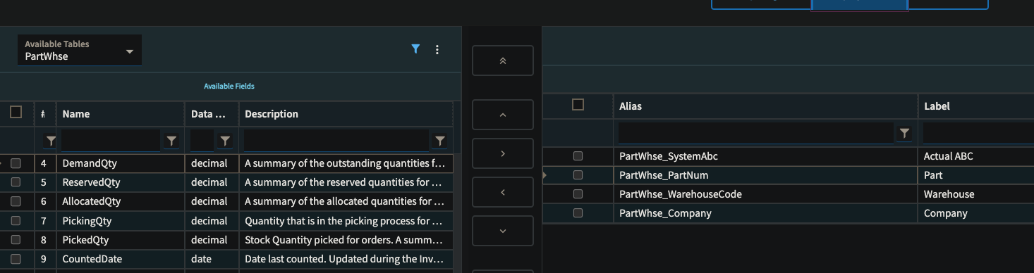

Use the PartWhse table, make the SystemABC criteria <> empty constant
and that will give you your list of ABC Codes that exist on every part

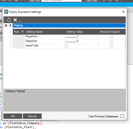

Another thing you can do is to go to the Query Execution Settings (under the Actions menu in E10) and set “RemoveTestRowLimit” to True
