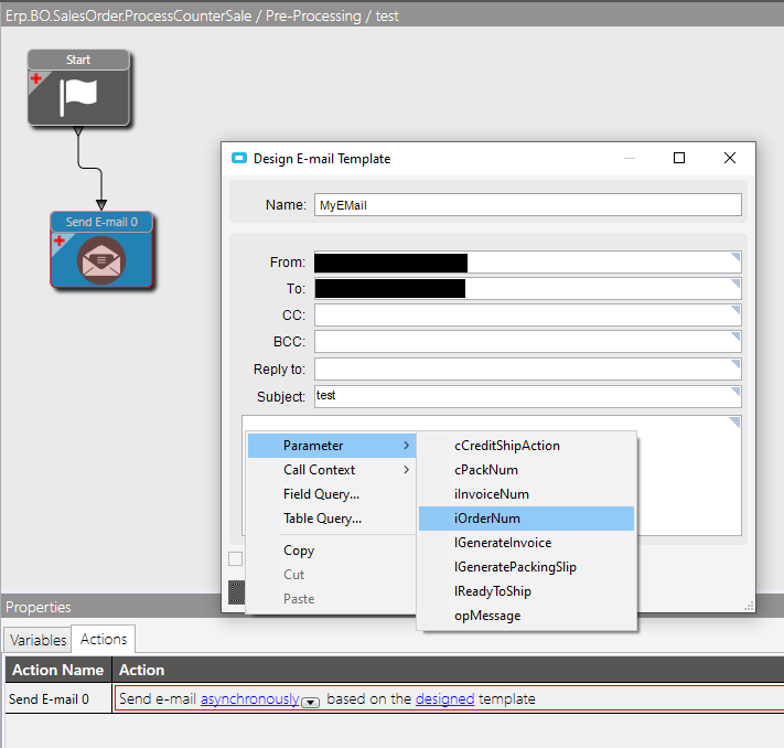

The fields you need are frequently not directly available (depends on the method).
So you have to 1) figure out what fields you do have at your disposal and 2) use those to query what you need.
I usually just fire a email to myself and insert whatever variables are available.
In this case, order number would be useful. If that’s not blank, you can use it as a parameter in a Fill Table by Query widget. I think you also need a Sales Order Tableset variable to put your query results in, and THEN you can check those values.

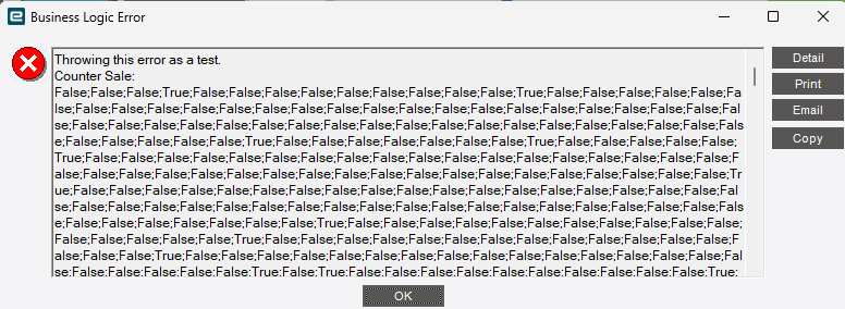

I then mapped those field to the exception to see if it printed anything then.
When I tested, I got a lot of Trues and Falses instead of one for each field I mapped.
Where did I go wrong?

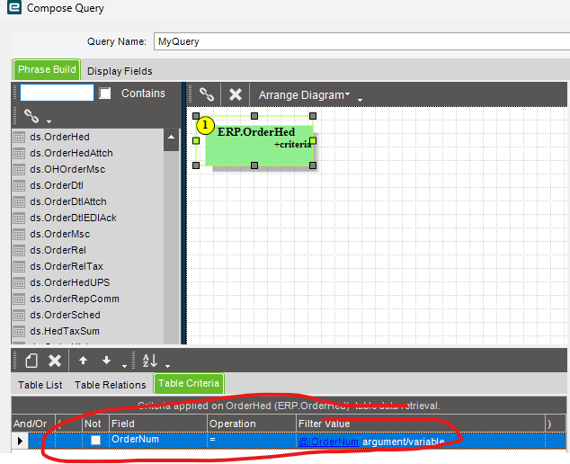

Hello,
I think I figured it out.
I had to do a table criteria in the fill table by query.
Once I did that, it started returning single results instead of a lot of them.
Now that I know this, I can get this going. Thanks!
