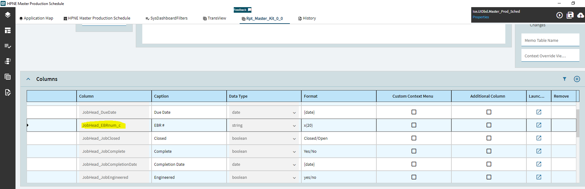

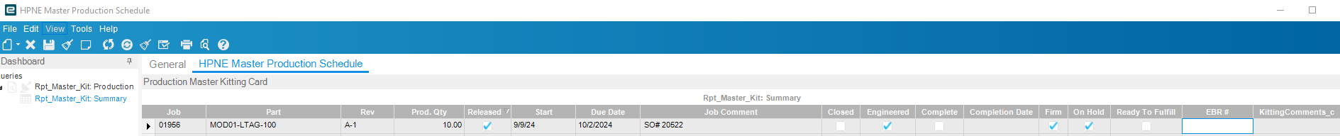

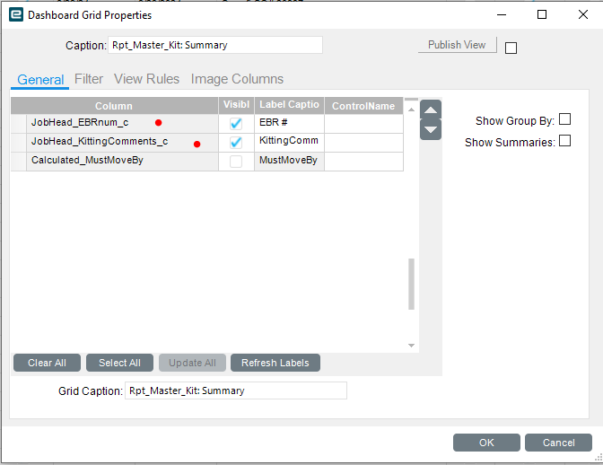

I created TWO UD fields in my JobHead table as seen in screenshot below. I NEED to be able to type into these fields. Our Kitting department head will use this dashboard. The user needs to be able to type into both fields.
1 called JobHead_EBRnum_c field
…and the other called JobHead_KittingComments_c.
I don’t know where to make this happen. =(
How do I make it so I can type into these two UD fields??

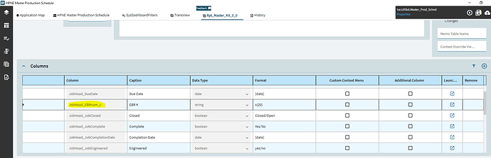

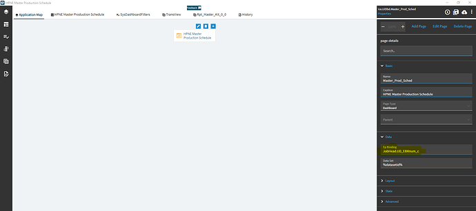

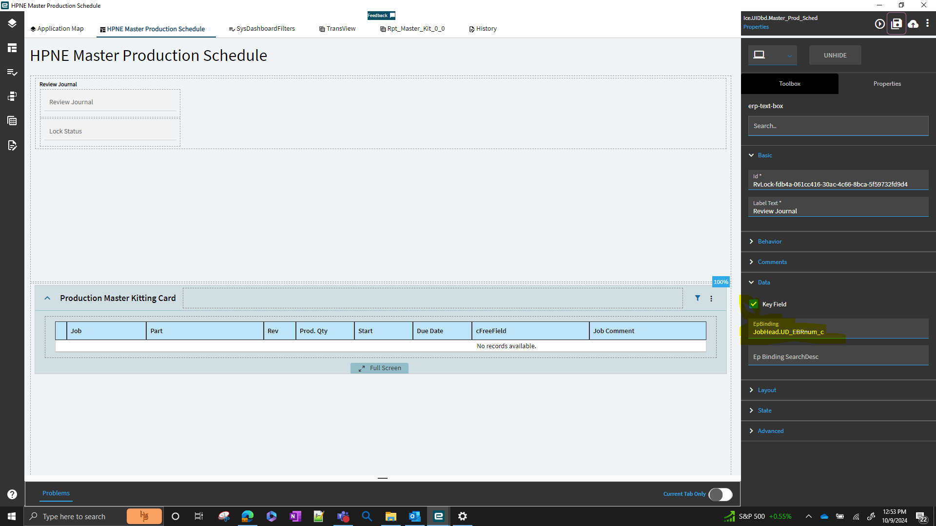

I tried adding Ep Binding but that did not work
@Lingsharr
Sounds like you are needing an updatable Dashboard.
First you need to setup your BAQ as Updatable and then the Dashboard.
Then you can either setup a Classic Updatable Dashboard
(see the ICE User Guide for that)
Or you can assign the UBAQ to a grid, this post might help you (depends on your version)
How To: Kinetic - Updateable UBAQ in a Grid - Experts’ Corner - Epicor User Help Forum (epiusers.help)
